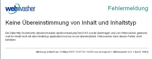

Am I the only one receiving this message?
 A6 2.5L TDI AKE - Performance issues, later turbo
 File size:  33.96 KB
 Viewed:  4845 times

It works for me (but I don't have WebWasher running). Perhaps it only recognizes .xls files as Excel files? I didn't choose that guy, though.

Post21-05-2007, 13:57    Subject: A6 2.5L TDI AKE - Performance issues, later turbo Quote
I'm not receiving the message from WebWasher.
It's probably an issue with you, your company, or the provider.

Post21-05-2007, 16:22    Subject: A6 2.5L TDI AKE - Performance issues, later turbo Quote
Okay, you're right. I'm not getting any notifications at home either. However, I did take a look at your first file. As mentioned in this forum, your file isn't really usable (or I don't want to put in the effort to make it usable). I even converted it to a CSV file, which was a waste of time.

Oh yeah, the WebWasher icon_cry.gif.
It's certainly well-organized, no question about it. Simply because it's not overloaded with so much data.
