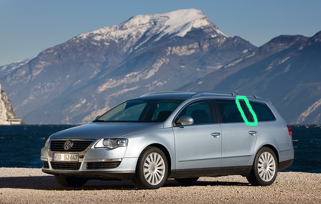

Post18-06-2007, 10:24    Subject: Exploded view rear door 3C Quote
This part seems to be sparking:

bloesch
Joined: 03/18/2005
Posts: 622
Location: FL
Post18-06-2007, 10:48    Subject: Exploded view rear door 3C Quote
hmm... so, there are also "cracks" in the roof area (apparently only appearing at higher temperatures)... however, they are mainly in the B-pillar area.
I would personally hand the car over to the dealer. Why would you bother with that?
searching for sounds can be very (time-)consuming...
