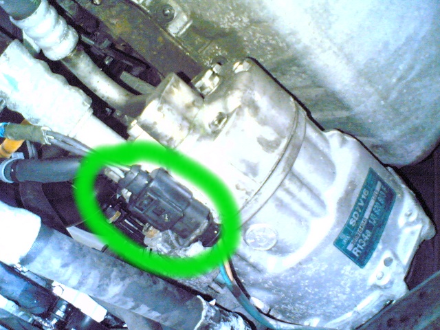

Hi.
Is that the control signal for the magnetic coupling?
The cables are rubbing against the air conditioning pipes, and one is almost completely worn through icon_sad.gif.
How do you do that again?

Post22-06-2007, 21:15    Subject: AC Compressor Hose Replacement Quote
Hi Martin, what kind of vehicle is that? I'm guessing it's not your Passat.

Post22-06-2007, 21:29    Subject: AC Compressor Hose Replacement Quote
NE.
It's a Leon 1M ASV, model year 2001.

Post23-06-2007, 21:34    Subject: AC Compressor Hose Replacement Quote
Hello Martin,
Yes, that must be the clutch.
According to my records:
Brown/Black = Ground (GND)
Green/Black = Plus.
Best regards, Jochen.

Post25-06-2007, 9:23    Subject: AC Compressor Hose Replacement Quote
In the photo on the left, you can see that I temporarily wrapped some Panzer tape around it.
How do I replace the cable?
Because it disappears further up in the cable harness.
I thought I could simply replace the entire plug with a new one that has 2 wires, then solder it just behind the wiring harness, put a heat shrink tube over it, and that would be it.

Post25-06-2007, 9:40    Subject: AC Compressor Hose Replacement Quote
"If the cross-section is already starting to degrade, I would do it this way. Otherwise, I'll use heat shrink tubing and see if I can mitigate the wear point with a cable tie."

Post25-06-2007, 13:17    Subject: AC Compressor Hose Replacement Quote
The cross-section of the cable now only consists of two strands of the wire and a lot of green insulation material... so, "it's necessary" (or "it has to be").
