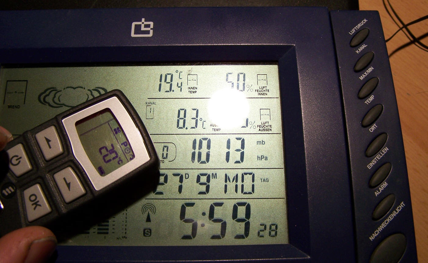

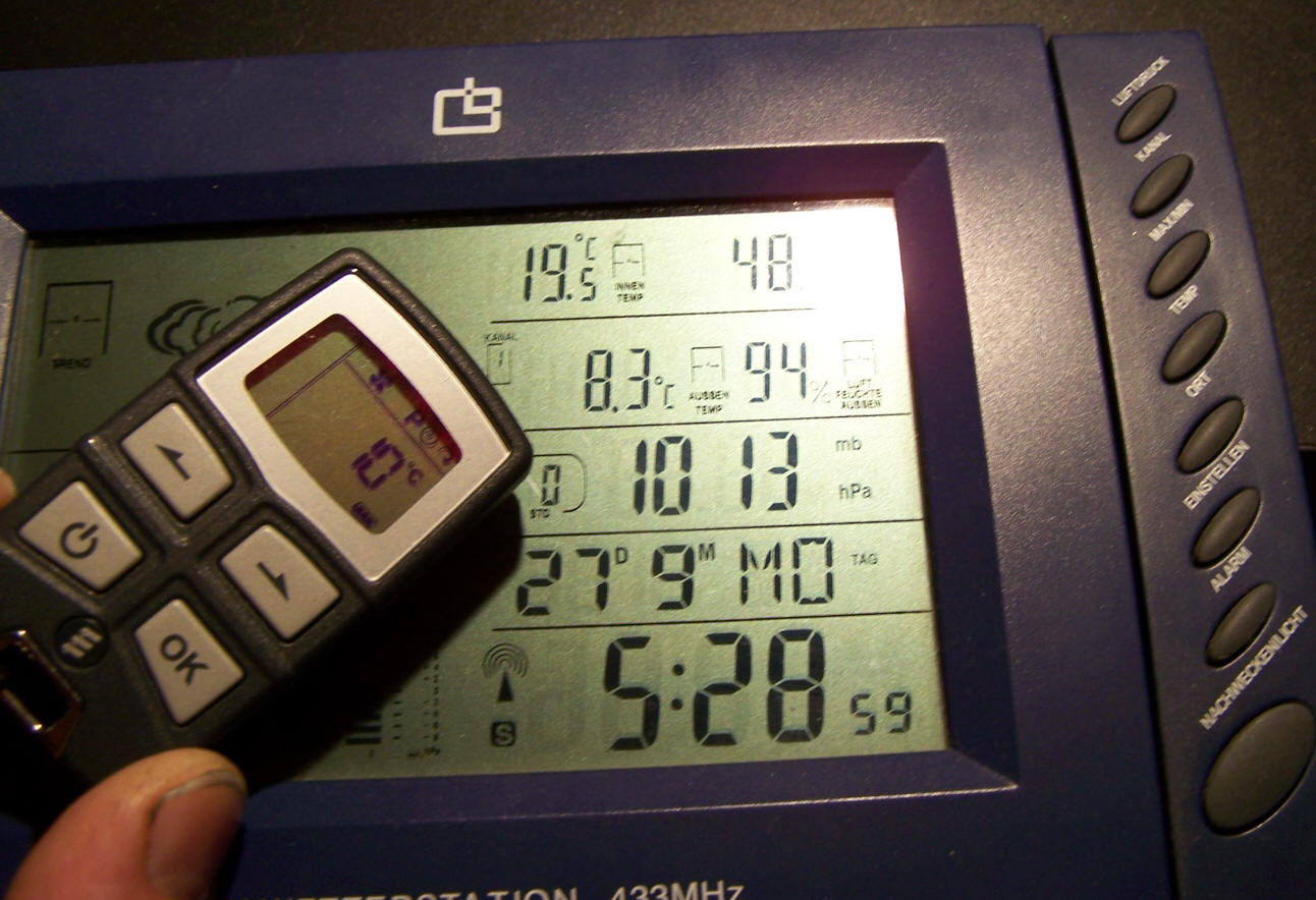

Post27-09-2010, 20:43    Subject: Passat 3B: Climate Control HE Mode Activation Quote
First run this morning with no changes whatsoever:
 File size:  154.49 KB
 Viewed:  5235 times
 File size:  184.14 KB
 Viewed:  4688 times
Passat Variant BGW 2005

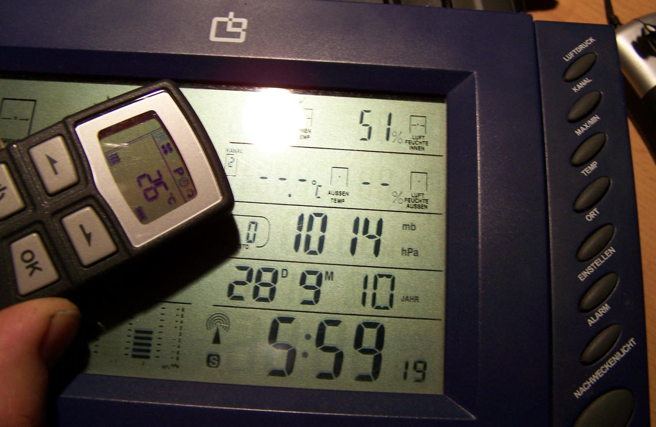

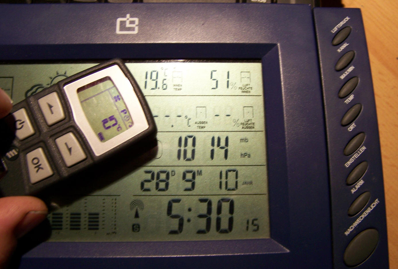

Post28-09-2010, 19:02    Subject: Passat 3B: Climate Control HE Mode Activation Quote
Second run. Although the outdoor temperature display on the weather station malfunctioned last night, you can see on the remote control that the interior of the car is again at exactly 10°C, just like the day before. This time, the climate control was manually set to 28 degrees Celsius in automatic mode and with the fan running at level 4 at 5:40 AM. With the same temperatures and heating duration, the result is significantly different.
 File size:  161.21 KB
 Viewed:  4735 times
 File size:  151.35 KB
 Viewed:  4694 times
