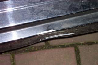

Today, I got a dent in the Polo's longitudinal member below the B-pillar from hitting a sharp edge: The estimated depth of the indentation is about 8 mm, approximately 20 cm long, and up to 3 cm high (in the area of the deepest indentation) icon_mad.gif.
The paint and stone chip protection layer has been scratched away down to the metal in a section of approximately 2 cm, but the metal itself is not frayed or torn; it still has its full thickness.
Outside of the bulge, there are no paint cracks or similar imperfections that could indicate broken welds or other issues.
As a rust preventative measure, I first applied a layer of gray stone chip coating. It looks great, but that's not my primary concern right now.
Question: Could this problem also cause me to fail the next vehicle inspection (due in March '09), even without any subsequent rust damage, because "load-bearing structures are deformed"?
If so, what are the permissible repair methods, and what should be considered when repairing the galvanized body of a 9N model?

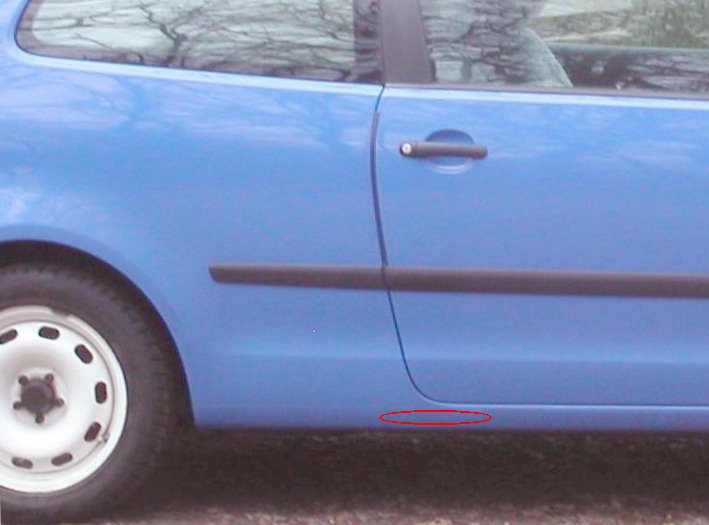

Joined: 04/13/2002
Posts: 11058
Location: Saarland
Post17-07-2008, 20:31    Subject: Dent in the longitudinal member - no more MOT (or inspection)? Quote
BM wrote:
Hmm, the longitudinal beams actually end in the area of the B-pillar, or is the sill (lower crossmember) meant?
For an assessment or a reasonable repair proposal, I need some clear photos.
I won't be able to get those today. Therefore, as a starting point, here is an old cropped image where I have marked the location of the damage in red. icon_wink.gif
The vertical position is likely correct, but the front-to-back position might be off by a few centimeters. The indentation depth is at its maximum at the front end of the line and tapers down to zero towards the rear.
Previously, I didn't have a clear understanding of the difference between "Längsträger" and "Schweller," but now "Schweller" seems more appropriate to me.
Thank you, by the way, for your interest }.

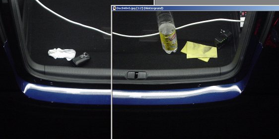

Post17-07-2008, 21:03    Subject: Dent in the longitudinal member - no more MOT (or inspection)? Quote
Ulf.
Perhaps now is the perfect time for impactful images.
I had a defect in the rear bumper (from the factory) that was very clearly visible when illuminated with a fluorescent lamp (which I happened to have on hand).

Post17-07-2008, 21:30    Subject: Dent in the longitudinal member - no more MOT (or inspection)? Quote
dieselmartin wrote:
I had a defect in the rear bumper (from the factory) that could be very nicely visualized using a fluorescent lamp (which I happened to have).
No, it sounds like yours was about 1-2 mm of unevenness on large, flat surfaces.
However, the painted areas of my car have a factory-applied "orange peel" texture (a type of protective coating under the paint).
I just checked again with the calipers and ruler: Compared to the convex normal contour of the sill, the depression is a maximum of 4 mm deep, and the maximum width of the depression (top edge to bottom edge) is approximately 4 cm.
I've replaced the attachment above with a different version that shows the bulge more clearly. It already looks quite bad; initially, I had estimated the depth of the bulge to be almost twice as much.
By the way, it's quite symmetrical and deepest at about its midpoint.

Joined: 04/13/2002
Posts: 11058
Location: Saarland
Post18-07-2008, 7:21    Subject: Dent in the longitudinal member - no more MOT (or inspection)? Quote
Jan6K wrote:
My sister hit a bollard with the right side of her Twingo (which has since been scrapped due to a timing belt failure...) two or three years ago while turning - it was bent much more than what you describe... No one noticed or cared during the one or two TÜV inspections the car had afterwards.
Von daher denke ich, dass du dir da keine Sorgen machen muss.
BM wrote:
It's annoying, but it's not a major problem. It shouldn't be an issue for the vehicle inspection (HU). The most durable repair would be one where the galvanization remains intact. That, in turn, is only possible if the sill is accessible from the inside. Perhaps the dent can be reached from the side panel. However, I'm not sure what reinforcements might be in the way there. To check that, you would have to remove the rear side trim.
I already checked: There are at least two layers of sheet metal in the way between the rear seat footwell and the back of the bulge -> I removed the bolt that holds the seat belt buckle (= in the innermost layer of metal) and inserted a screwdriver, but it didn't even go half as deep as the distance to the bulge is icon_sad.gif.
To achieve internal riveting, you would need to drill through at least these two layers of metal – is such a thing even permissible?
The back of the dent would likely be accessible through existing longitudinal holes located between the bottom edge of the sill and the vertical weld seam. The technician would need to work "around the corner" to reach it, potentially using the next inner panel as a support. However, the dent is quite well positioned between two such holes, meaning the distance in the direction of travel is at least 20 cm.

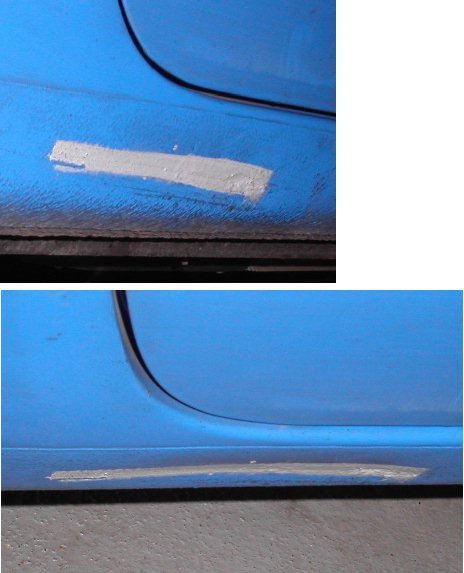

Post18-07-2008, 14:30    Subject: Dent in the longitudinal member - no more MOT (or inspection)? Quote
Here are two more actual pictures of the mishap.
A body shop doctor in this area offered to repair it for €140.
I would get the bare metal parts (requiring you to drill holes and remove them; then you'll need to do your own surface treatment, although achieving that perfect "orange peel" finish is less important to me) for €50.
The latter option would also be more appealing because the car only needs to be taken to the workshop for a few hours, and I can wait. For a complete job, it would take two days due to the drying times of modern water-based paints.

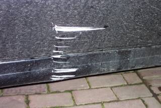

Post18-07-2008, 23:02    Subject: Dent in the longitudinal member - no more MOT (or inspection)? Quote
ulf wrote:
Hi Bertil,
Even though I'm not particularly concerned about the appearance of my Polo after almost 4 years: the bump bothers me just as much as you describe. Therefore, I will probably accept the €50 offer and then paint over it icon_rolleyes.gif
Hi Ulf,
ich habe mit meinem Polo (6N2) vor mittlerweile über 4 Jahren einen Blumenkübel "beiseite geschoben". Die Auswirkungen an der Beifahrertür (ist ein 2 Türer) kannst Du auf den Fotos sehen (einmal von der Seite und einmal bei geöffneter Tür von oben). Den Kübel hänge ich auch mal an; man sieht auch gut, wo er vorher stand.... Der Schaden wurde (wenn mich meine Erinnerung nicht trügt) nach der von BM beschriebenen "klassischen Methode" behoben. Fazit: Ich sehe von dem Schaden nichts mehr. Und was vielleicht noch wichtiger ist: Ich sehe auch noch nichts wieder (z.B. Rost o.ä.). Der Träger wurde damals noch von innen mit Wachs geflutet. Die Methode kann ich also empfehlen. ÜI never worried about the TÜV (German technical inspection), and they never said anything to me either.However, the damage is no longer visible. As a temporary solution, I also sprayed underbody protection over it back then.
Best regards, Thorsten.
