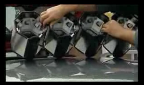

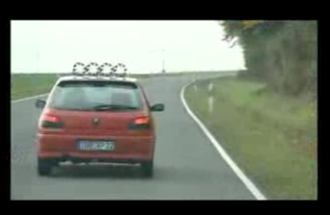

He installed those four diamond-shaped pieces on a very old 306 diesel engine.
I could tolerate the calculations about air resistance, but when he started talking about a "much smoother running diesel engine," that's when I decided he was just full of hot air.
The old steam hammer machine in that car can only be silenced by stopping it completely; you won't achieve silence by simply putting a V2A mesh on the roof.
Please note the bulky edge protectors, also known as "bump strips." Just those alone create turbulence that must increase fuel consumption. Apparently, some "enthusiast" with a 3C Highline had magnets attached to the roof to hold pipes in place... completely freehand and unaligned.
Magnets in the sprinkler system are much better!!!

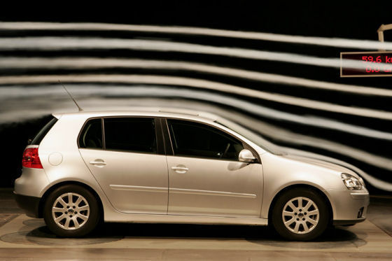

I hope I'm not infringing on any copyrights right now.
That's probably what it looks like in the compact car class.
