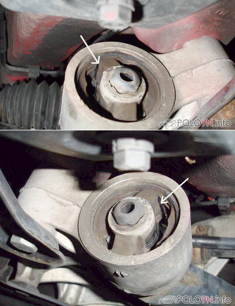

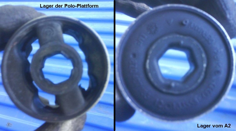

In the Polo 9N platform, the rear transverse link bushings on the front axle are designed as soft rubber shims, which allow for approximately 1 cm of play in the transverse link, both inwards and outwards, and are a source of various clunking and creaking noises.
In the "Damaged Suspension" attachment, you can also see the typical points of failure in the vertical rubber supports (at the top), which may require replacement after only a few tens of thousands of kilometers.
As a solution, solid rubber bushings from the A2 model can be installed. In the 9N.info forum, these bushings are often praised for providing noticeably improved steering precision. Whoever wants to read that: CLICK
I'm now wondering what advantages the "Wabbel" suspension system actually offers, or what subtle (handling-related?) disadvantages one incurs when switching to A2 bearings.

Thank you for your informative answer, but I'm talking about the front axle (VA), and specifically the rear transverse control arm bearings there. icon_lol.gif

Furthermore, it should be noted that road bumps are almost unfiltered and transmitted to the chassis and steering system, which does not necessarily improve their durability.
That is the description for full rubber (instead of the standard stepped) bushings, if I understand correctly.
And just one more question about that:
The rubber shims in the standard bearings only loosely center the rear control arm pivot. In the event of impacts, the rear end of the control arm is initially accelerated sharply to the right or left and then slams against the stop of the rubber bushing – which is somewhat soft, as the inner mounting bracket and the outer bushing shell are made of the same rubber part.
However, what always comes to mind is a heavy piece of luggage in the trunk that starts to slide during sudden acceleration, braking, or sharp turns, and then slams against the backrest, tailgate, or inner fender (we can even put a piece of carpet or something similar in between to cushion the impact of the rubber). If the load is properly secured, it cannot start moving, and no more jolts will be transmitted to the vehicle's body.
According to my opinion, the A2 full rubber bushing corresponds to the principle of securing a load, as the rubber bushing still has some elasticity and can filter out sudden forces acting on the control arm by giving way slightly – just as elastic luggage straps would dampen the force transmission to the body if, for example, someone bumped into the luggage.
Here's the translation:
In my theory, I don't necessarily see higher material stress due to road bumps, etc., when converting the Polo to A2 suspension. icon_rolleyes.gif
What do you think about it?
BM
Avatar-BM
Joined: 12/07/2005
Posts: 1857
Location: Nähe Düsseldorf
Post10-09-2008, 13:02    Subject: Wobbly control arm bushings on Polo / Ibiza / Fabia Quote
That is the description for full rubber (instead of the standard bridge-) bushings, if I understand correctly.
Sorry, no - this applies to polyurethane; with solid rubber, the same effect occurs, but likely in a less pronounced form.
In my theory, retrofitting the Polo with A2 suspension components doesn't necessarily lead to higher stress on the materials due to road bumps, etc.
You can't compare this to a loose piece of luggage rattling around in the trunk (Force = Mass x Acceleration). This effect will not have a significant impact on the control arm because the short travel distance to the stop prevents any substantial acceleration.
Ultimately, despite all the considerations, I would also opt for the solid rubber bearings. Perhaps they aren't as tough as they seem.
