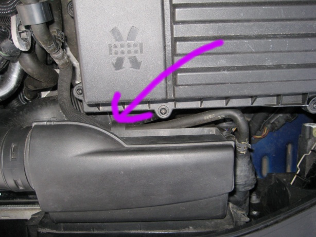

Hi.
Between the suction nozzle and the LuFiKa, the thin "coolant return" hose runs. It has an extra thickening to prevent it from chafing. Because one end is connected to the motor and vibrates with it, while the other end is fixed to the radiator.
Unfortunately, the hose was lying around very loosely.
Does anyone have any ideas on how to calm him down?
Interestingly, it seems to be quieter when the engine cover is on, because then it presses his "engine end" slightly downwards, which keeps him firmly pressed against the intake manifold.

Post06-03-2009, 21:44    Subject: 3C: Chiller return line rattles Quote
I don't see a problem there, or are you hearing that clattering sound? Is there a way to attach it securely nearby, perhaps using a cable tie?

Post07-03-2009, 10:37    Subject: 3C: Chiller return line rattles Quote
Hi Martin,
Just cut out a thick foam ring and glue it on. For years, there has been a Glitzi sponge under the air filter box of my A3, with the rough side facing the air intake.
Don't worry about the rust on the car; it's just somewhere else.

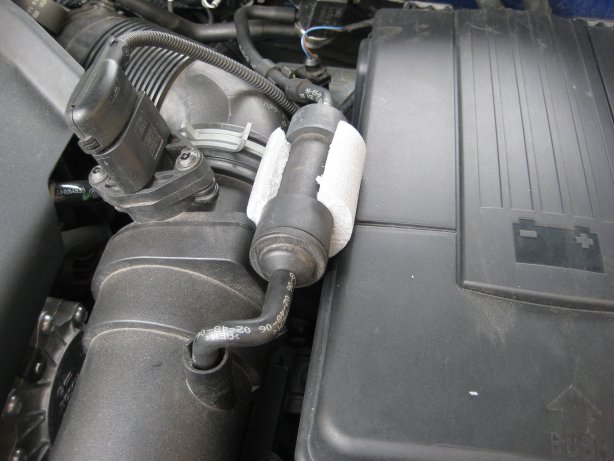

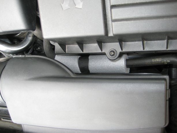

Post20-05-2009, 8:09    Subject: 3C: Chiller return line rattles Quote
Okay.
That stupid hose never stays where I push it.
Therefore, I secured him (and also the ATM throttle next to the mass airflow sensor):

Posts: 18102
Karma: +799 / -0   Thank you, like it!
Post20-05-2009, 9:15    Subject: 3C: Chiller return line rattles Quote
Cool idea with the heating pipe insulation icon_smile.gif.

Post20-05-2009, 9:20    Subject: 3C: Chiller return line rattles Quote
Rainer K. wrote:
Thank you icon_smile.gif.
- cheap
- works.
- If it's too tight, the insulation will be the first thing to rub away - so it won't damage any original parts.
The clip connection "thick U-shaped pipe to LuFiKa inlet" already showed clear signs of wear, so I reinforced it with original VW fabric tape. (Unfortunately, no photos were taken).

Post20-05-2009, 11:18    Subject: 3C: Chiller return line rattles Quote
Sure.
Exactly that. I searched for a long time too.
000 979 950 Textile adhesive tape, black, approx. 5.00€ per piece.
Original VW and, surprisingly, even affordable icon_smile.gif.
With Alex, you can see how it is.
http://www.passat3c.info/cms_neu/index.php?page=152
I wrapped a layer of it around the U-shaped tube and then clipped it back into the air filter housing. It's now firmly attached and without any rattling.
