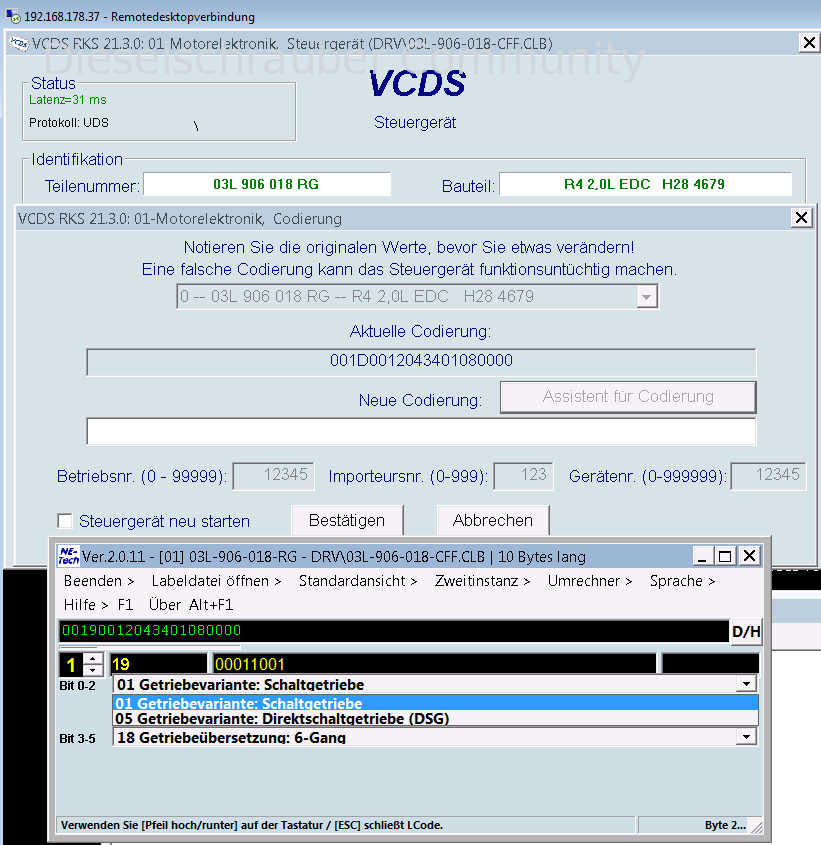

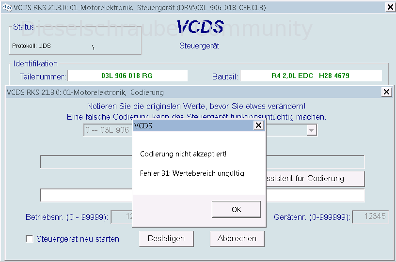

The engine control unit (ECU) EDC17C46 (03L 906 018 RG), with engine code CFGC, cannot be re-programmed from DSG (dual-clutch transmission) to manual transmission. While I can select the manual transmission option in the coding assistant, I receive an error message when confirming the coding: "Coding not accepted! Error 31: Invalid value range!"

Is this engine control unit with this VAG part number available in cars with manual transmissions?

Hello Rainer,
Unfortunately, I can't tell you that. I didn't realize that the transmission of the donor vehicle was so important; I would need to do some research first.

Post04-06-2021, 21:17    Subject: Engine control unit cannot be coded for manual transmission Quote
It appears that the software version was only available with DSG. icon_evil.gif

Post05-06-2021, 15:56    Subject: Engine control unit cannot be coded for manual transmission Quote
With software version 03L 906 018 RK, the problem is solved. icon_biggrin.gif

Post03-01-2022, 14:12    Subject: Engine control unit cannot be coded for manual transmission Quote
Hello David,
You need to check which coding options are allowed for the software version of your control unit, meaning which transmissions/engine features, etc., were originally available. You can only code what was originally offered. If you need a different coding, the easiest solution would be to purchase a control unit with the appropriate software version. The last two letters are crucial.

Post03-01-2022, 18:08    Subject: Engine control unit cannot be coded for manual transmission Quote
You must enter a completely valid encoding, not just individual features.
Even if you don't have the original, you need a version with software that covers all the existing features; otherwise, it simply won't work.
