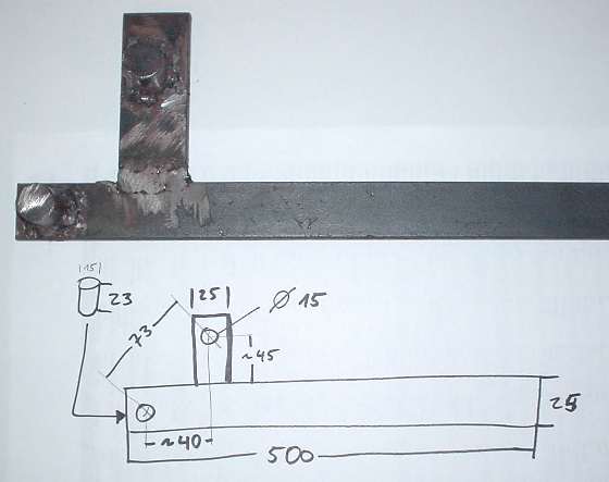

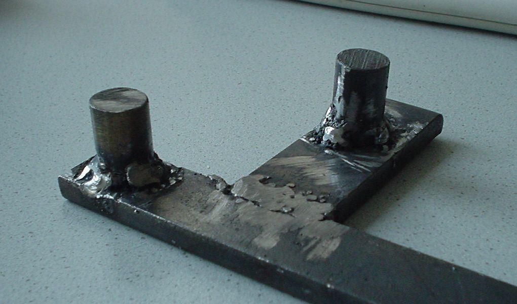

- There's still a small roller between the cam and the ESP unit - replace that one too.
- Do you have a camshaft sprocket holding tool? Use something sturdy; I almost couldn't get the screw off, and then it got stuck.
