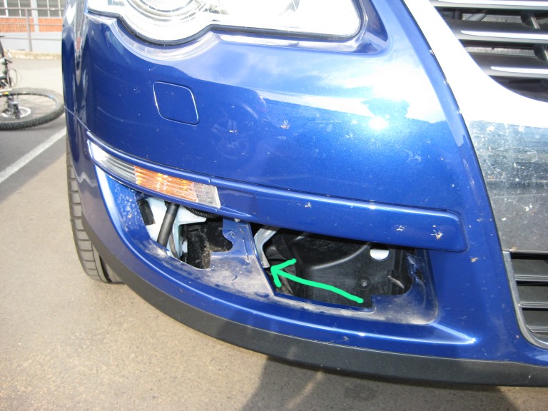

Post20-06-2007, 10:17    Subject: Horn Location: VW Golf 3 (Mk3) Quote
Here's another photo of the last known location of my low-pitched horn.
By the way, the Nebler is now only screwed directly into the plastic – no more metal spring nuts (cheap, cheap).

Post20-06-2007, 15:01    Subject: Horn Location: VW Golf 3 (Mk3) Quote
Hehe... it looks like a picture of an accident: the front part is "damaged" and the bicycle is lying on the ground.
Duck and cover...

Post20-06-2007, 15:17    Subject: Horn Location: VW Golf 3 (Mk3) Quote
Oops, you're right.
and to top it off, the right fork leg has actually broken off!
