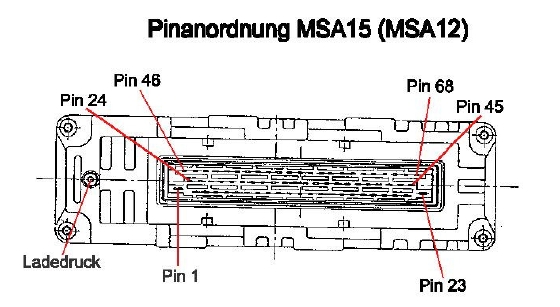

Pin33: Ground/Mass.
Pin 40 signal output.
Pin 41 +5V
Translated on 04-10-2026, 9:13.
| Back to top |
Profile PM |
Pfusch und Fünfg'rad
Joined: 09/26/2008 Posts: 7 Karma: +0 / -0
22-03-2010, 14:50 Subject: Golf TDI Ride Height Adjuster Upgrade (1Z) |
Quote |
Thank you. These are the connections as shown in the wiring diagram I have.
Only where can I find the connector (in the wiring diagram T68), pins 33 / 40 / 41? Which pins are those?
That is the information that I am missing.
Stefan.

Please  .

The outer contacts on the connector are numbered, while the others can simply be counted.

@ Wiesel: Finally, someone who understands me  . Thank you!!!
"@slow-moe: Nooooo, I only have the ECUs (an extra 94 model for tinkering) here, and I was desperately searching for a numbering on the connector (sorry, not a plug - I wrote that wrong). Of course, I didn't think about the connector in the car (since there's another 94 ECU installed there)."
@Rainer: I used the search terms "pinout" or "connector layout," but I didn't find anything under "pin layout."
Thank you for your patience!
Problem solved, time to get out the soldering iron.
