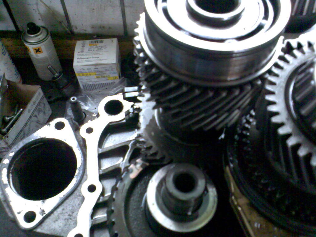

Post24-09-2009, 18:47    Subject: Touran Rattling Noise: Causes & Fixes Quote
Yep... this one gear was missing 3 teeth!
He didn't say it directly, but it seems like it's not an isolated incident.
VW pays 50%, but I'm still stuck with the €1500 for the automatic transmission! :-/

This is the drive gear for the 4th and 6th gears.
