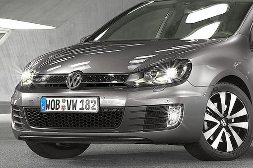

I have been searching the internet for about 6 months.
None have really good pictures, except maybe:
http://www.postimage.org/image.php?v=TsJt0Dr
http://www.postimage.org/image.php?v=TsJtd69
That also explains why Xenon cars have fog lights and, therefore, are more expensive.
Turn restrictions: 0 EUR
Nebler as a turning aid: 0 EUR
Nebler therefore included with Xenon: 180 EUR (standard Nebler surcharge)
I specifically drove into a parking garage (dark) during the test drive to assess the visibility of the fog lights when turning.
In our G5, I have configured the fog lights as turn signals (thanks to the MJ08)). But you can't see anything from the light... which is also clear regarding the positioning of the nozzles:
http://graphics.gestionaleauto.com/gonline_graphics/1317322_E_4b82b49be81d8.jpg

Smashed? Both?? Rockfall?!
And why am I reading 35W? Shouldn't the fog lights have 55W? Standard H7?!
B. t. w.: The fog lights on my 206 were not only set too low, but also completely crooked. On the left, it was almost okay, with a range of about 7-8 meters. However, on the right, it was directly in front of the car. My initial suspicion, during the first drive in the dark with the tried-and-tested fog lights at low beam, was that the right light was defective. But that wasn't the case! The conclusion was that one simply installed the items without any further effort or correction.
| Back to top |
Profile PM |
Roger Profi-Schrauber
Joined: 10/11/2002 Posts: 3035 Karma: +88 / -0 Location: Rodgau 2017 Volkswagen Golf Premium Support
20-05-2010, 13:08 Subject: Golf 6, BCM, and Kurven Xenon |
Quote |
Hutfahrer wrote: | Broken? Both?? Rockfall?!
And why am I reading 35W? Shouldn't the fog lights have 55W? Standard H7?! |
That's right. In GTD/GTI, it's H 8 with 35W.
Normal G VI have HB4 with 55W.
Quote: | | The conclusion was that one simply installed the devices without any further effort or correction. |
VW has been doing this for decades, out of tradition. At least every one of my new cars since 1990 had this problem. Parts were thrown onto the assembly line and installed that way. There was no control, neither in the factory, nor during delivery. My Xenon headlights were also much too low again.
GruĂ

Hutfahrer wrote: | Why are 35 W flashlights used? Doesn't that result in very little light output? |
These are the questions that the guys in WOB need to ask  . I suspect they were originally intended for use as TFL, but they didn't get approval, and now they're just filling the otherwise empty installation space. The BCM can also easily dim them, for example, to 50%. They certainly look good, I admit  .
In the G VI, a wide range of exotic lighting solutions were introduced. For example, the standard models now have their TFL (Twin Filament Lamp) in the long-range spotlight, which is realized using a 35⏠H15 double filament lamp with 15/55W. The turn signal lamp is a mirrored PSY 24W SV, and is supposedly also available at a similar price range.
Lighting devices, see also:
http://www.michaelneuhaus.de/golf6/golf6-tips.shtml#birnen
