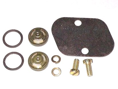

The gasket under the cover is part number N 90415901 (52x2). Below that, there are two more "seals" installed: part number 068145117B (a washer) and part number N 90414601 (38x3).
"And for other, older pumps, there is still a repair kit with check valves; perhaps something similar is installed in that one? Of course, the cover is not for the 1Z pump. The VAG part number is 068198819; comparable versions are also available from TOPRAN, etc., and it looks like this:"
