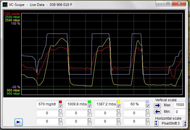

I bought a VCDS license because I think my Passat with the AFN engine is slow.
I just completed this scope run. My speed was 5th gear / approximately 90 kilometers per hour.
Is this a 'typical' pressure buildup?
Best regards,
Jacob.

09-08-2010, 23:13 Subject: Boost Pressure Build-up AFN Engine |
Quote |
Incorrect manifest. Please record manifest number 11. However, it already looks somewhat abnormal.

Quote: | | Is that a "normal" pressure build-up? |
Unfortunately not. Please upload the unaltered log file (MWB 11) here so that it can be properly viewed with KDataScope.

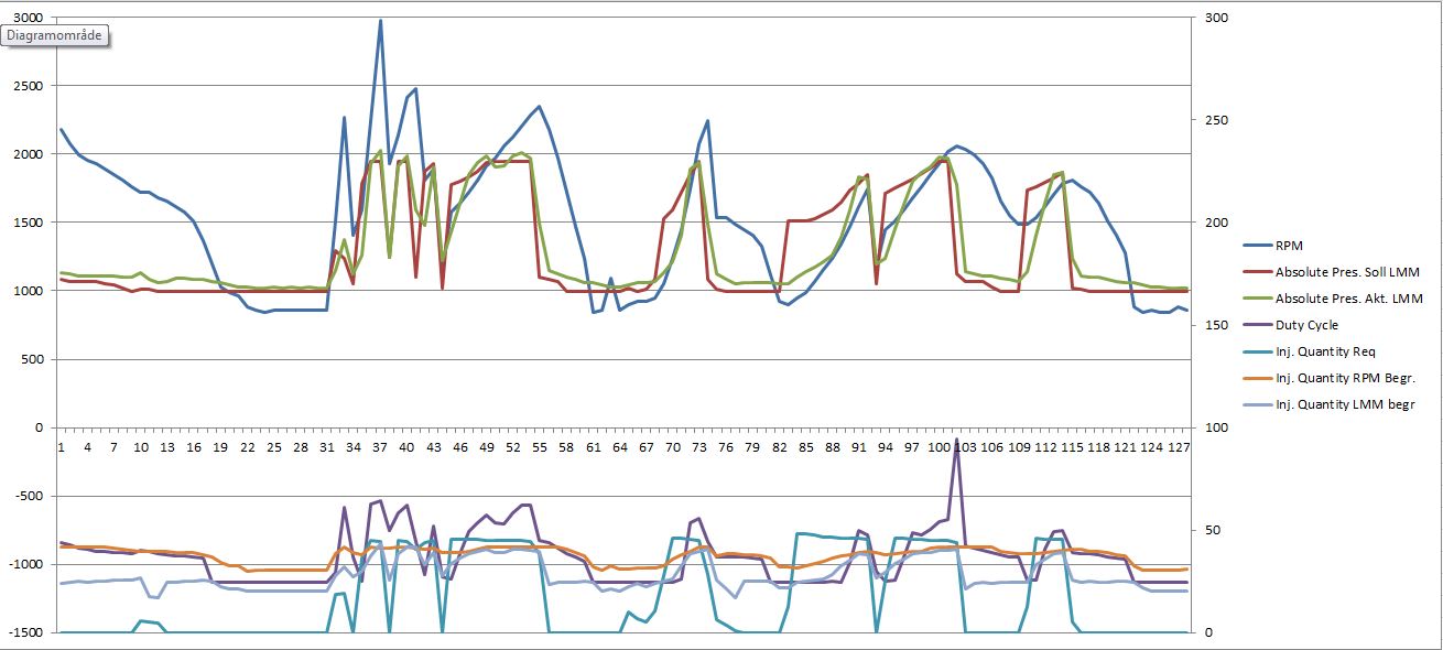

Here you can find sections 3, 8, and 11 of the 'MWB' (likely referring to a specific document or standard).
best regards
Jacob.

10-08-2010, 11:18 Subject: Boost Pressure Build-up AFN Engine |
Quote |
Wrong link... sorry.

Why don't you just do what is asked?  You really lose the motivation that way.
Your lambda sensor is either defective or the actual exhaust flow is too low due to obstructions in the intake manifold or exhaust system.
