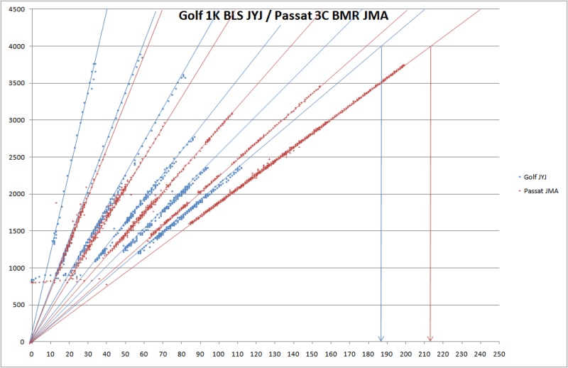

Post02-03-2011, 9:05    Subject: 6-speed gearbox, why such short gearing? Quote
Here's the diagram for the Golf 5 105 HP TDI 6-speed (BLS JYJ MQ250).
This is short!!!

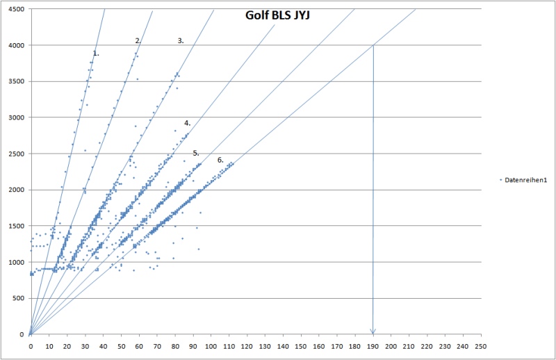

Post02-03-2011, 22:20    Subject: 6-speed gearbox, why such short gearing? Quote
Okay, I understand. Please provide the German text you want me to translate into English. I will only provide the translation.
 File size:  89.69 KB
 Viewed:  20897 times
