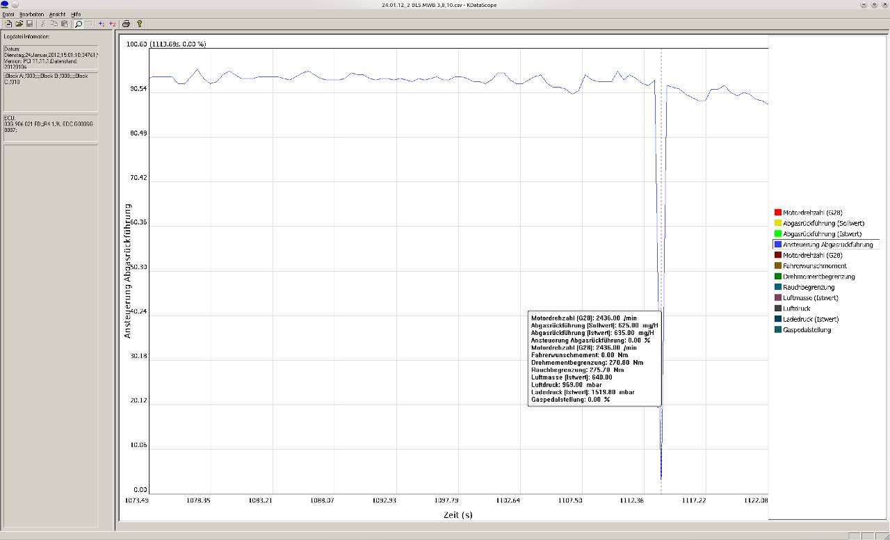

Post24-01-2012, 19:14    Subject: Golf V TDI 1.9 BLS: Performance Data & Specs Quote
I logged in twice today. Once, the injection was MWB 18.23.7, and the second time it was MWB 3.8.10.
"I have another question: Does anyone have experience with the acceptable range for the fuel temperature measured by sensor G81? Yesterday, I saw a reading of 53 degrees Celsius above ambient temperature (which was 3 degrees Celsius). Could this potentially indicate a leak in the common rail pressure sensor between the fuel supply and return lines?"
Best regards,

Post24-01-2012, 19:43    Subject: Golf V TDI 1.9 BLS: Performance Data & Specs Quote
"Except for the spike, the log looks good from the perspective of potential errors. However, like your other logs, it doesn't provide much information."
It doesn't make much sense to always log the same conditions when the error doesn't occur.
If logging is to be done, it should ideally cover as many load states as possible, especially those where the error occurs.
If the "problem" doesn't appear directly in the log and is only occurring sporadically, I'm afraid you'll simply have to wait until the problem a) occurs more frequently/constantly or b) is logged in a way that it appears in the log and can be reproduced.
What happened to the readiness status?
PS: With PD injection, the fuel flows through the cylinder head, which is why it's perfectly normal to have slightly higher fuel temperatures.
 Spike im AGR Tastverhältnis. Sofern bei halbwegs gleichbleibenden Umgebungsbedingungen Spikes auftreten, spricht das für Regelprobleme.
Die Regelung versucht dann immer stärker den Sollwert zu erreichen und die Stellgrösse läuft weg.
