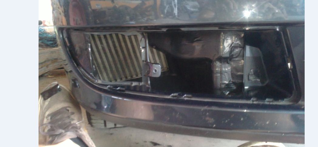

Hello everyone,
I performed a modification of the intercooler piping on a Polo 9n3 with a 1.9 TDI BLT engine.

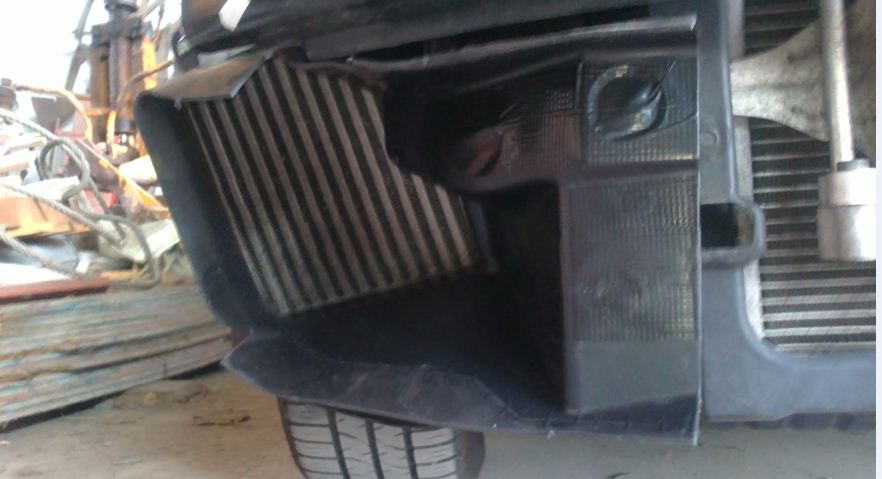

Instead of the original part, a Seat part with the number 6L0805639A was installed.
This part is the SMIC steering rack from the Ibiza FR/Corboda TDI.
Besides, I cut a slot in the fender to better vent the air that has flowed through the radiator (according to theory), following this guide: http://www.polo9n.info/Wissen/anleitungen/optimierung-der-kuehlluftfuehrung-zum-ladeluftkuehler

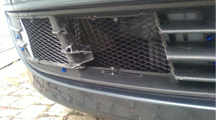

Furthermore, the air intake was cut out as much as possible and then re-covered with a racing mesh grille.
The Seat part fits the bumper better than the original part, and it is overall "tighter" against the bumper than the original two-piece air duct.
The holes in the Seat part were closed with fabric tape.
The following values were recorded for measuring devices 7 and 11 on the highway:
Outdoor temperature 28-29°C.
Intake manifold temperature, maximum: 99-109°C (max. 80° above ambient temperature).
A ride from last week with the original air intake and slot in the wheel arch revealed:
Outdoor temperature 24-25°C.
Maximum intake manifold temperature: 94-100°C (max 75° above ambient temperature).
I'd be interested to hear your opinions, as I think that, if there has been any improvement at all, it's only been minimal. However, I haven't noticed any significant deterioration either.
Can I simply compare the two trips with each other?
The conditions are always different when it comes to traffic flow, gas pedal usage, etc.
Are there any data logs or log files from another BLT driver available?
What are your experiences? Please tell us what you think! (Even if you think it's irrelevant...)
Attached are the log files and some pictures of the event.

Post05-08-2012, 11:22    Subject: Polo 9n: Intercooler Modification 6L0805639A - Your Opinion Quote
Furthermore, I cut a slot in the fender to better vent the air that has flowed through the radiator.
Depending on the specific 9N model and year of manufacture, the air may or may not be able to escape after the catalytic converter. In the worst-case scenario, the wheel arch liner can completely block the airflow after the catalytic converter.
If that is the case, then a conversion makes sense, as the differences in charge air temperature and performance are significant.
If the wheel arch already allows for good airflow of the coolant from the factory, further modifications will only have a minimal impact. Removing any existing fog lights may provide a slight improvement.
I will not analyze your logs because they were created without careful consideration, and therefore their informative value is unfortunately zero. It is not possible to determine the vehicle's speed, fuel injection rates, ambient air pressure, wind conditions, etc. from the logs.
