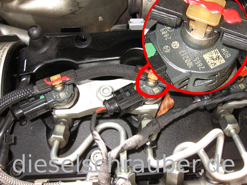

Hello Martin,
The CFFB engine in the 2010s A3 (103kW CR TDI) has a Bosch injection system with solenoid injectors and an EDC17CP46 engine control unit.
In theory, the piezo injector should be able to react faster, and therefore model the injection process more accurately. At least, that was the case with the piezo injectors used in the previous generation of common rail systems.
SSP445 wrote:
The company Bosch has developed an injector valve with magnetic valve technology, which meets the requirements for high injection pressures and the ability for multiple injections per combustion cycle.
Solenoid-controlled injection valves have the advantage of being easier to manufacture than injection valves with piezoelectric actuators.
That is to say, current solenoid injectors appear to be technologically just as good, but are simply cheaper to manufacture.
For the engines I am familiar with that use piezo injectors (CAYA, CAYB, CAYC 1.6l TDI), there also seem to be some minor issues with the long-term durability of the injectors.
Perhaps that's the reason for the shift.
