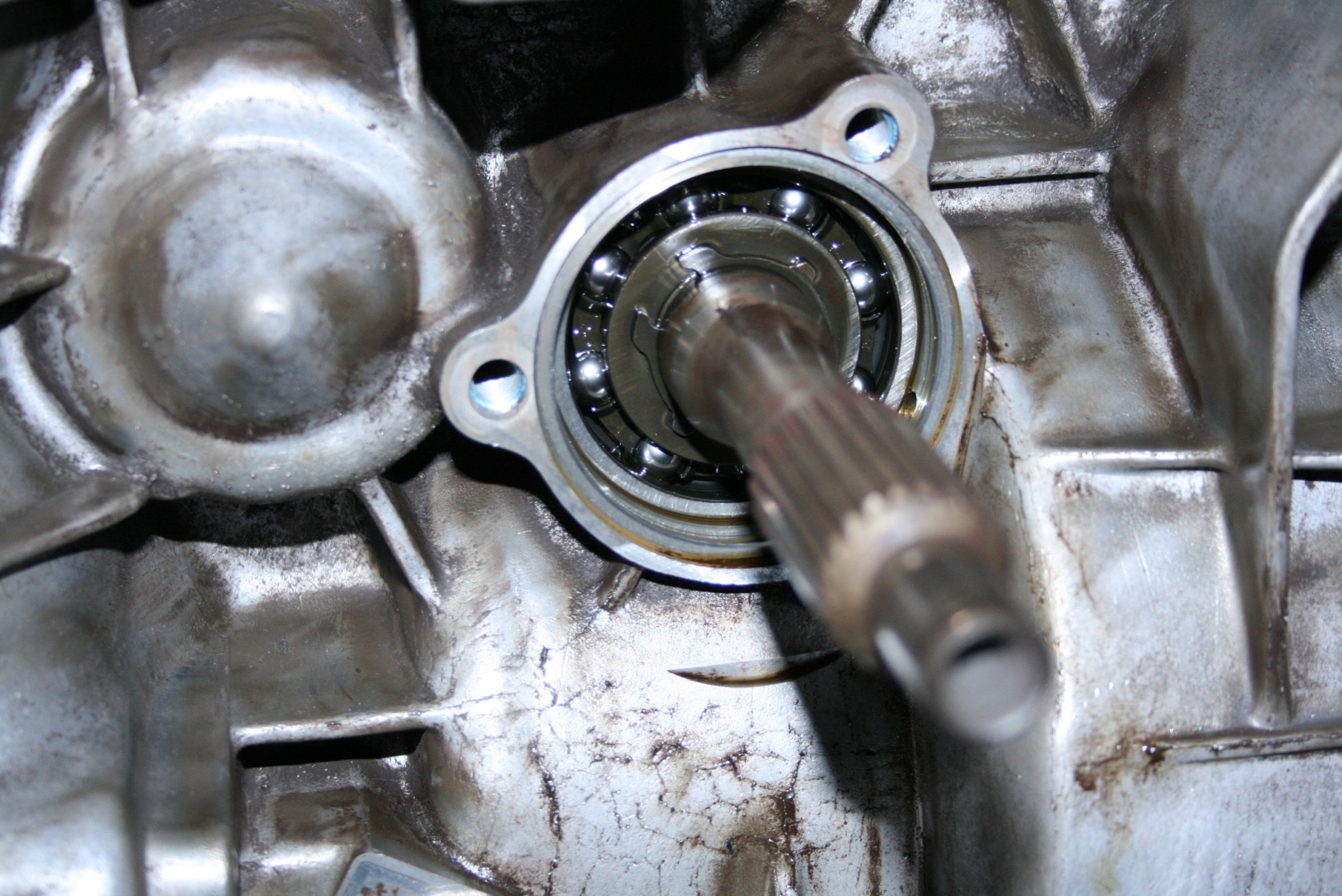

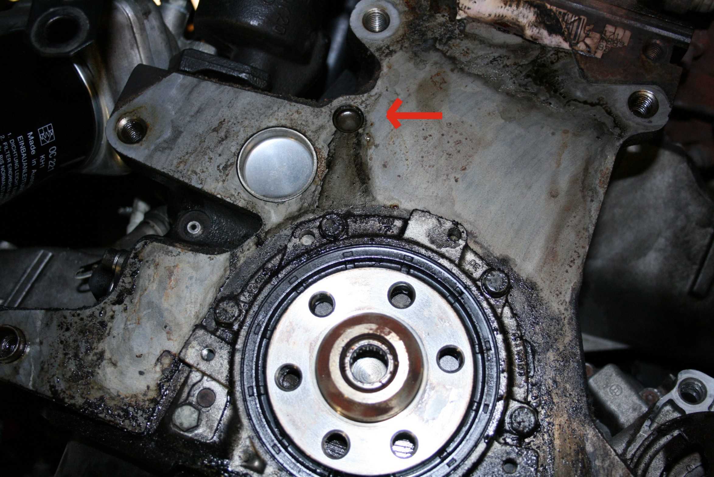

Two questions:
- In one of the pictures, you can see the engine block (1Z) from the transmission side. What's behind that small cover on top? The leak appears to be oil, but I'm not sure if there are any traces of coolant, so I'd rather ask.
- In the second picture, you can see the gearbox with the drive shaft and the drive shaft bearing.
How do you remove the bearing if you don't have VW 1582 and VW 1582/2? There are various ball bearing pullers for standard bearings, such as 6205 (25x52) or 6305 (25x62). I need a puller for a bearing with dimensions 25x58x16 that will also keep the bearing cage intact.
Has anyone ever done this before?
Best regards.

Post14-01-2014, 19:50    Subject: Third gear shifting/synchronization (resolved) Quote
Hello Herbert.
Regarding the engine:
Behind the large cover is the auxiliary shaft (which drives the oil pump/vacuum pump). Behind the small cover runs the main oil channel, extending from back to front through the engine block. All bearings and lubrication points are supplied by this channel.
I had the same problem when I was rebuilding my 1Z engine. Back then, I tapped a thread into the block and installed a sealing plug without a flange, using a threaded gasket.
Regarding the transmission:
You need something like this:
http://www.werkzeughandel-roeder.de/kfz-werkzeuge/pkw-lkw-abzieher/kugellager-abzieher/kugellager-abzieher-1291.html
Mpire.
Translated on 19-07-2026, 17:33.

Post14-01-2014, 20:06    Subject: Third gear shifting/synchronization (resolved) Quote
What is behind the small lid on top?
That should be an empty borehole.
...who also leaves the storage cage intact. Has anyone ever done that before?
As far as I know, it's not possible to do that without damaging the storage area. The storage cage is just in the way.
"On my 3-speed gearbox (which is roughly the same design), I welded two screws onto it and removed it using two pullers – a bit of improvisation, really. The bearing itself is actually quite loose inside the gearbox."
Translated on 19-07-2026, 17:35.

Post15-01-2014, 10:23    Subject: Third gear shifting/synchronization (resolved) Quote
"Thank you!"
"@Mpire: Have you ever used that puller for this? Gedore offers two sets of hooks specifically designed for roller bearing removal with a shaft diameter of 25 mm, each intended for bearings 6205 or 6305 (housing diameters of 52 mm or 62 mm). They might fit, but they don't necessarily have to. The bearing in question has an outer diameter of 58 mm."
As far as I understand the mechanism, the hooks on the outer ring are engaged and rest against the inner ring when they are rotated parallel to the axis. However, this requires that the hooks and the bearing are compatible with each other.
Best regards.

Post15-01-2014, 17:29    Subject: Third gear shifting/synchronization (resolved) Quote
I didn't use that exact puller from Gedore. I used one with the same principle, and based on your description, you understand how it works icon_biggrin.gif.
The bearing – if it has a metal cage – remains intact, but plastic cages usually become brittle when used. They become fragile due to the influence of oil and heat.
There's also this principle that uses small, movable hooks, which then...
to cover a wider range of bearing sizes and are also replaceable.
https://www.begaspecialtools.com/demontage/mechanische-abzieher/betex-abziehwerkzeuge/betex-56-4-arm-kugellagerauszieher/4-armiger-kugellagerauszieher-betex-56-020/2-1-1-1-10551-4-0/
@AutoserviceViewing profile: Autoservice
Behind this cover is definitely the main oil channel; I've already removed the cover myself. When you shine a light on it, you can also clearly see the connections for the injector nozzles that supply oil to the pistons icon_wink.gif.
Mpire.
