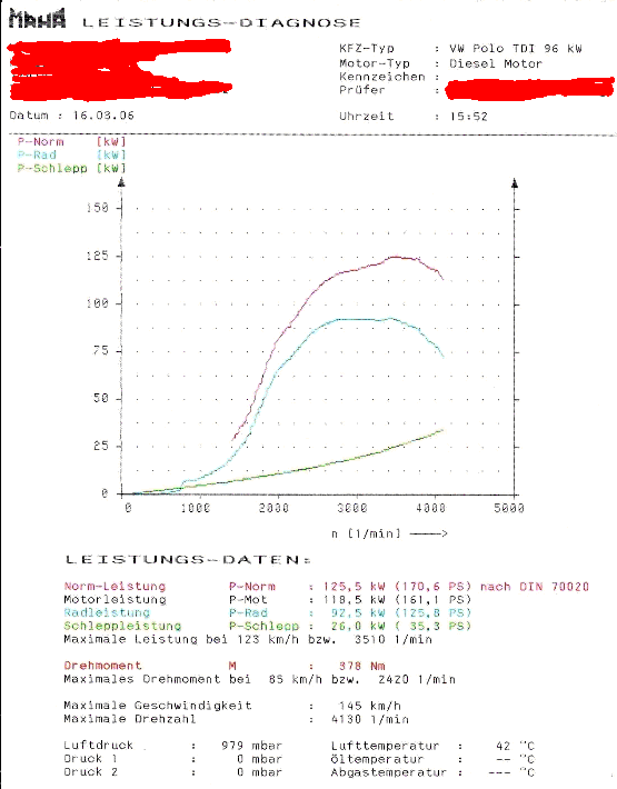

Just now, I found a great performance chart online that shows legal horsepower scams:
The measured 161 PS are converted to sea level and 20°C, taking into account the ambient temperature and air pressure (42°C / 979 mbar), where a naturally aspirated engine apparently requires 171 PS according to the standard correction factors.
What does the 9N-ASZ software actually tell us?
The torque limiter does not have an ambient pressure correction, and the full load pressure is maintained down to 980 mbar ambient pressure.
42°C air temperature (in March - what kind of sauna is the test stand in? (Or are they measured somewhere in the intake duct?) The LLTs will barely reach 80°C under full load on the test stand within a few seconds, at which point the thermal protection measures begin to reduce the amount.
Therefore, the tested TDI under (vacuum) normal conditions would no longer consume any diesel, would not have any more boost pressure of mbar, and thus would not deliver the tired 161 hp as measured.
A chip tuner who is knowledgeable about the software also knows this (or at least knows where to look).
However, one can enter 10 PS more as the standard performance and represent one's own advertising of 170 PS as achieved, based on a standard that does not recognize TDIs.
If we assume that a healthy ASZ typically produces around 140 horsepower, then the tuner has only added around 21 real horsepower – and can proudly point to almost double the gain on paper:
171 measured standard horsepower minus 130 catalog horsepower = 41 horsepower tuning success!
The moral of the story?
The world wants to be screwed, and anyone who doesn't participate is to blame icon_confused.gif

Ich weiß nur das es ein unterschiede bei den Messungen gibt, es gibt ne Messung nach EG-Norm, diese fällt in der Regel höher aus, der seriöse Tuner jedoch misst nur nach DIN. bei meiner Messung hätte ich damals auch nach EG etwa 170ps gehabt, nach DIN waren es 161. laut dem bekannten von mir werden aber auch Serienfahrzeuge mit der EG-Norm gemessen.
Bei der Lufttemperatur, können sie ja nur LLT genommen haben, bei 42°C Umgebungstemperatur würde ich mein Auto aus Prinzip schon nicht messen lassen

I have also mentioned this elsewhere (a company in Ulm). Good thing it was in 2001, but it was similar. However, the temperature was okay, but all vehicles that were rolling out of the gate had a recorded air pressure of 945 mBar.

Aron wrote:
I have also mentioned this elsewhere (a company in Ulm) – good thing it was in 2001, but similar pattern. However, the temperature was okay, but all vehicles that were rolling out of the gate had a recorded air pressure of 945 mBar.
Hi Aron,
a company in Ulm... let me guess, chip tuning is not offered there?
Edit:
945 mbar is actually the average ambient pressure at an altitude of 540 meters above sea level, and this corresponds to approximately Ulm.
This results in a Pnorm surcharge of approximately 7% on the measured result, which, as mentioned earlier, does not have a real basis in TDIs (at least partially).
Edit:
This results in a Pnorm-adjustment of approximately 7% on the measured result, which, as mentioned earlier (at least partially), does not have a real basis in TDIs.
No, the company name ends with "Motorsport"... I looked at it in a bad way when I left, and that day, according to weather.com, there should have been around 1000 hPa.
Currently, the pressure is even above 1000 hPa. The conversion was 1:1. Even if it's only about 5 paper KW in the end, it's still not nice.
Do the air pressures in the weather data actually correspond to the altitude in some way? Maybe the air pressure sensor only measures in 50mbar increments. icon_lol.gif

Aron wrote:
Do the atmospheric pressures in the weather data actually correspond to a certain altitude? Maybe the air pressure sensor only measures in 50mbar increments. icon_lol.gif
Yes, the pressures are converted to sea level (otherwise the weather maps would show perpetual hurricane lows icon_wink.gif )
However, the cars must compensate for this by matching the actual thin air in terms of height, so it is correct to measure with the local pressure. The test results are converted to sea level (and 20°C) according to DIN standards - even though this deviates from reality for TDIs.
Are there any more ways to harass people on the server?
A lot. It is also quite effective and discreet not to disconnect during installation. This increases the calculated power by adding the losses of the dragged motor.
Gentle (even) braking essentially works the same way.
Conversely, the calculated power output can be somewhat reduced if, instead of simply decoupling, the gearbox is switched to the LL (e.g., as a pre-measurement by a chiptuner icon_evil.gif).
BTW: I'm also curious to know what the approximate performance gain would be between "rolling out with gear without decoupling" and "rolling out in LL" without any modifications to the engine. . .

Was sagt uns aber die 9N-ASZ-Software?
Die Drehmomentbegrenzung hat keine Umgebungsdruck-Korrektur, und der volle Ladedruck wird hinab bis 980 mbar Umgebungsdruck gehalten.
Wo fragt der Wagen den den aktuellen QNH/QFE ab? Ich dachte der geht immer um den hinterlegten Faktor (bein ASZ um 1,3 bar) über den tatsächlichen Umgebungsdruck.
Von daher sollte auf der Großglocknerstrasse bei 2500m auch nur einen Absolutdruck ca. 2,0 bar im Saugrohr herrschen, und nicht die 2,3bar bei Meereshöhe?
Dahingehend wäre der Tuner, der dort oben seine Bastelbude betreibt, schon angehalten umzurechnen, weil er sich sonst ins eigene Fleisch schneidet.
Oder reden wir wieder aneinander vorbei icon_wink.gif ?
Vielen Dank für Deine Antwort
Gruß Oben...
Joined: 04/13/2002
Posts: 11058
Location: Saarland
Post18-05-2007, 12:18    Subject: TDI Chiptuning: 10 PS legal increase = Done Translating...
[Translating...]
Er fragt nur das QFE (aktueller Außendruck) ab, per Sensor im MSG.
Nein, im LD-Soll-KF stehen absolute Druckwerte, wie sie auch beim Loggen rauskommen.
Das maximale LD-Soll wird aber durch ein Schutz-KF beschnitten, über das aus Außendruck (ebenfalls als Absolutwert, logo) und Drehzahl ein max. LD-Soll erstellt wird.
Ja, so in etwa.
Grundsätzlich richtig. Aber der Höhen-Leistungsverlust von TDIs folgt grundsätzlich nicht den einfachen Umrechnungsfaktoren der Benzinsauger-Norm: im Ergebnis werden TDIs (je nach Software! - soweit ich sie verstehe) frühestens unterhalb ~ 950 mbar Außendruck schwächer, wo Benzinsaugern schon ca. 6% Leistung fehlen.

ulf wrote:
... Aber der Höhen-Leistungsverlust von TDIs folgt grundsätzlich nicht den einfachen Umrechnungsfaktoren der Benzinsauger-Norm
Deshalb gibt es auf ordentlichen Prüfstanden auch Tabellen für die Korrekturfaktoren in Abhängigkeit vom Fahrzeug. Meist sind die Bedeiner aber nur zu faul diese nachzuschalgen ..... icon_twisted.gif
icon_idea.gif Aah, jetztverstehe ich auch, warum manche TDI-Protokolle nur minimale Differenzen zwischen Pmot und Pnorm zeigen, obwohl Umgebungsdruck und -temperatur eigentlich ähnlich saftige Zuschläge wie im o.a. Diagramm zulassen würden.

meines Wissens gibt es eine etwas geeignetere Kennzahl, die von Maschinenbauern in diesem Zusammenhang lieber verwendet wird als das Drehmoment: Der Zugkraftüberschuss.
Ich kann nicht mit Formeln dienen, aber so weit ich verstanden habe, besteht das Argument gegen das Verwenden des 'Drehmoments' als Mass für das Beschleunigungsempfinden darin, dass die bewegliche Massen des Motors auch einen 'dynamischen Widerstand' gegen eine Drehzahländerung haben, also ein Motor dem man die doppelte Schwungmasse wie einem anderen verpaßt beschleunigt bei gleichem Drehmoment schlechter.
Das müßte sich auch auswirken, weil Diesel wegen der höheren Verbrennungsdrücke stabilere Pleuel, Kurbelwell, etc brauchen, was die Vergleichbarkeit zwischen Benzinern und Dieseln zusätzlich erschwert.
Vielleicht schönt man sein Ergebnis, wenn das nicht berücksichtigt wird. Es würde auch schön das Zähwerden mancher Diesel erklären.
Maschinenbauer? Weiß wer was?

ObenbeiMutti wrote:
Das mit den 7,8% -> 10PS Serienstreuung beim ASZ möchte ich trotzdem nicht glauben wollen. Hergeschenkt oder schlechtreferenziert wird herstellerseitig nichts! Dazu passen die GPS-geloggten Vmaxe einfach zugut zu den Werksangeben, Serienbereifung vorausgesetzt.
Meiner läuft lt. GPS exakt 1,0 km/h schneller, bei überfüllten Reifen.
Vmax in freier Wildbahn kannst Du meistens in die Tonne treten, weil jeder Hauch Gegen- oder Rückenwind 1:1 aufs Ergebnis durchschlägt. Für Mini-Gefälle und -steigungen gilt im Prinzip das Gleiche.
Mein Polo hat im Werkstrimm laut DZR in unzähligen Durchgängen immer zwischen ~ 138 und 143 PS gelegen - und ich habe die Eingaben penibel geprüft: Reifenabrollumfang gemessen, mehrere Wägungen machen lassen usw.
Such mal hier im Forum nach Leistungsstreuung usw.: die meisten Beiträge schlauer Leute bestätigen, daß TDIs im Schnitt die gesetzliche Toleranz von 5(?)% mehr als gut ausnutzen, ausnahmsweise zugunsten der Kunden.
Geht den K-Power oder der gute alter DZR darauf eigentlich ein?
Auf die Vmax natürlich nicht, weil das Meßprinzip ja auf Beschleunigung beruht.
