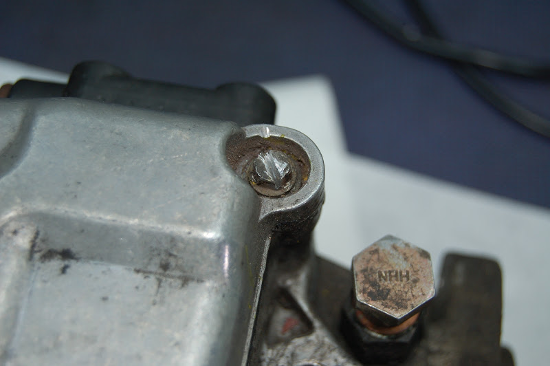

Post11-12-2012, 9:08    Subject: Triangle nut f. VP37 turnout frame Quote
Hey.
While not the most elegant or precise method, my approach (see attachment) involves using a Dremel.
Should it be replaced with a "standard" one?
Best regards,
 File size:  61.94 KB
 Viewed:  6466 times
klahaui
Avatar-klahaui
Joined: 08/13/2009
Posts: 1102
2019 Volkswagen Golf
Post11-12-2012, 9:49    Subject: Triangle nut f. VP37 turnout frame Quote
It also works with a good, sharp wire-cutting pliers.
To my uttermost dismay, I have even tried it with a hammer and chisel icon_biggrin.gif.
vwSchrauber
Joined: 09/18/2008
Posts: 1262
Post11-12-2012, 12:39    Subject: Triangle nut f. VP37 turnout frame Quote
If necessary, I can also do it with an 8mm Allen key that I hit with a hammer. However, such repair and correction methods do not look very professional to the customer icon_wink.gif.
