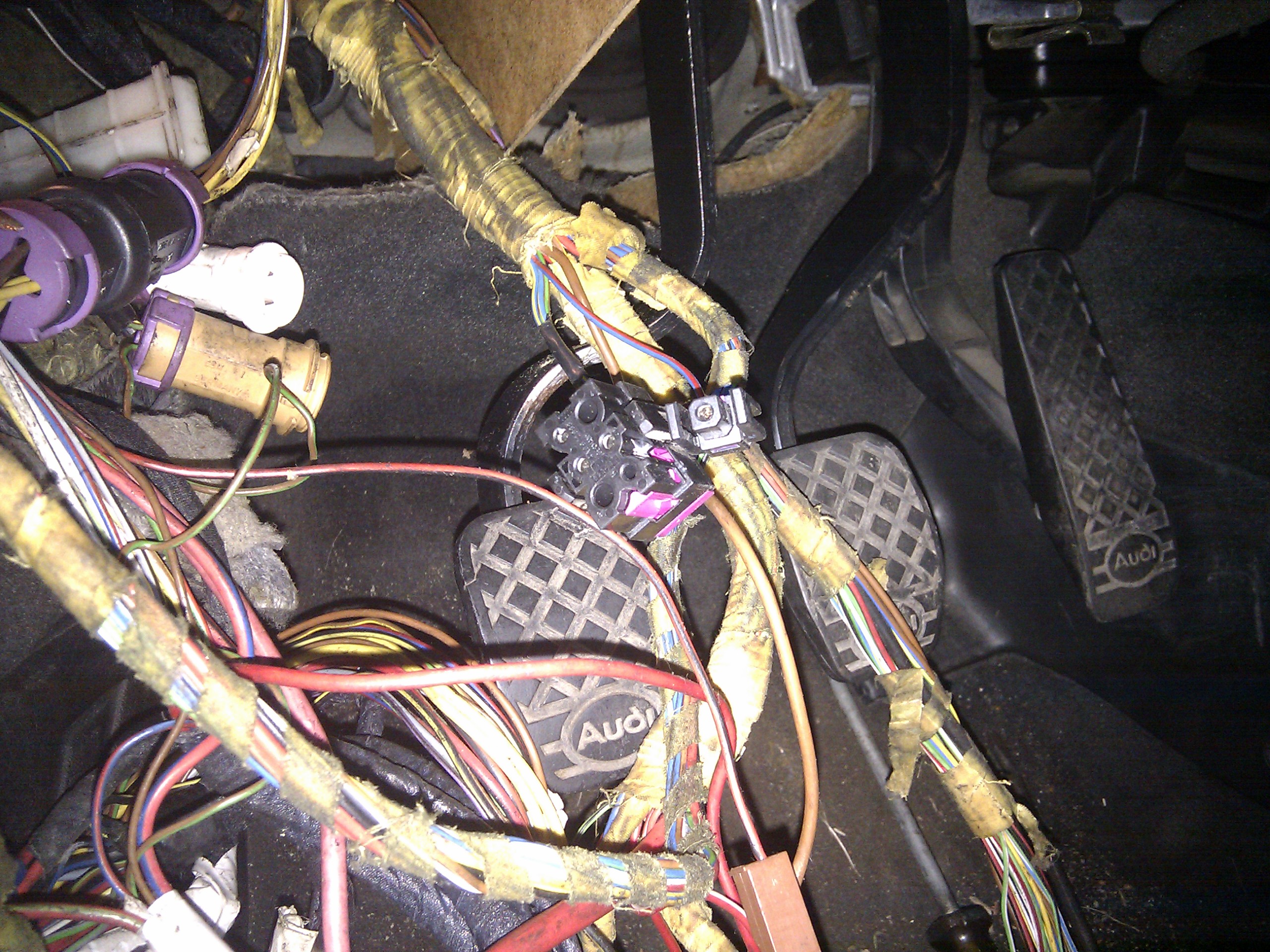

Post22-11-2012, 16:58    Subject: Audi 80 B3 2.0 E with cold start problems Quote
hello guys,
After trying and measuring without success, I decided to replace the injector.
So, I quickly and for a reasonable price, got a different fuel injector.
The choice fell on one of the ABKs, which had been equipped with a digifant system.
Okay, I'm running into a bit of a problem during the installation...
Unfortunately, Audi installed a somewhat peculiar instrument cluster.
Unfortunately, it's not foolproof; instead of each plug fitting only once, there are various types of flat pin connectors.
Now, with great hope, I've been studying the circuit diagram in the Etzold manual.
But even that doesn't reveal the secret of the ZE.
It seems that Audi changed some connectors during the B3/B4 model update. Since some pins may often remain unconnected, I can only guess. Please see the attachment.
To top it all off, the colors of the cables don't always seem to be consistent.
Mechanically, the problems are relatively minor; the fuel lines don't fit, and the intake manifold is a bit cramped. The fuel pump for the ABK engine is an in-tank pump, while the 3a engine uses an external pump. However, the 3a pump is more powerful (perhaps too powerful?).
I know I'm asking for a lot, but I would be very grateful for any information you can provide about ZE, etc.
