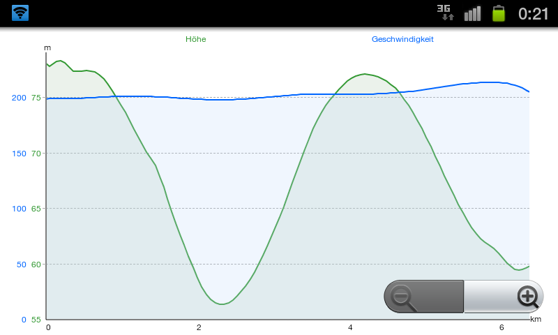

I also logged 3-8-11 again, maybe someone with more expertise can take a look. From my perspective, everything seems fine.
DPF: No modifications have been made. According to VCDS, it is at 129 out of 175. I have not logged the differential pressure, but it is 10 mbar when stationary.
Regarding the image: I'm surprised that he doesn't lose speed going uphill – in fact, he seems to be gaining speed. This suggests that there's power available and the engine isn't working at its maximum capacity...?
I'll check with VW to see if a new version is available and what changes have been made... I don't want the car to have even less power after that icon_wink.gif.
Best regards,
Marco.
 GPS Log - es erstaunt mich, dass er am Ende so schnell geworden ist.. Normalerweise geht er auch bergab nicht über 210...

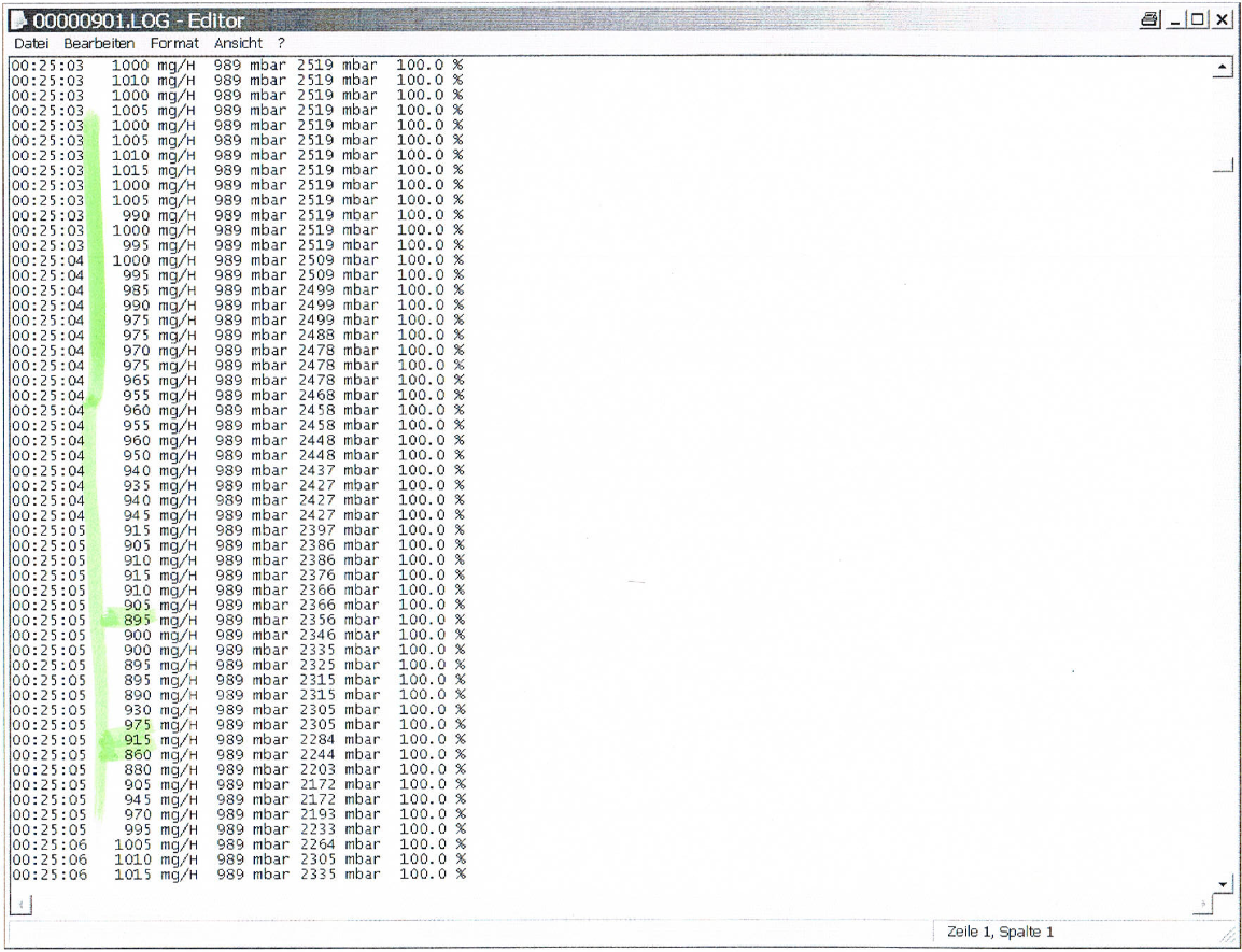

I need to bring this topic up again. Today, I expressed my dissatisfaction to VW WOB, stating that nothing has happened since April. Half an hour later, icon_smile.gif called me and asked me to come in.
Turns out, my car is absolutely fantastic and everything is working perfectly, and he can't figure out what's causing it. He suggested I try putting on 205 tires.
(Air mass, rail pressure, differential pressure (325 mbar), turbo control behavior, ...)
Einziger Hinweis ist die Luftmenge, die aus irgendeinem Grund zwischen 2000 und 4000 Umdrehungen irgendwie "einbricht" (s. Image).
The icon_smile.gif said that this deviation does not explain the problem or is unlikely to have a significant impact. I should now "replace" the wiring from the MSG to the MAF sensor, because the pins might no longer be making good contact. The MAF sensor is less than 10,000 miles old and made absolutely no difference compared to the old one.
So, it would now start with a "shotgun" approach to troubleshooting the icon_smile.gif, meaning replacing things like the catalytic converter or DPF, which isn't exactly "wallet-friendly" if there's no "guarantee of success."
Now, my question: Could a deviation of approximately 100 mg/H cause the needle to become permanently stuck at the 210 mark?
"Could a log using VCDS be helpful? If so, please let me know which measuring blocks are needed..."
Thank you in advance.
Marco.
 VW-Spezial-Log ;-)
 File size:  945 KB
 Viewed:  2689 times
Translated on 06-09-2026, 21:07.
mullemaus
Guest
Post25-09-2012, 18:34    Subject: CBBB Software: Performance Issues? Quote
Now my question: can the deviation of approximately 100mg/H cause the needle to be permanently stuck at 210?
No, that's due to the standard 210 km/h speed limit, which was already present in the 3736 model icon_wink.gif.
Translated on 06-09-2026, 21:10.
