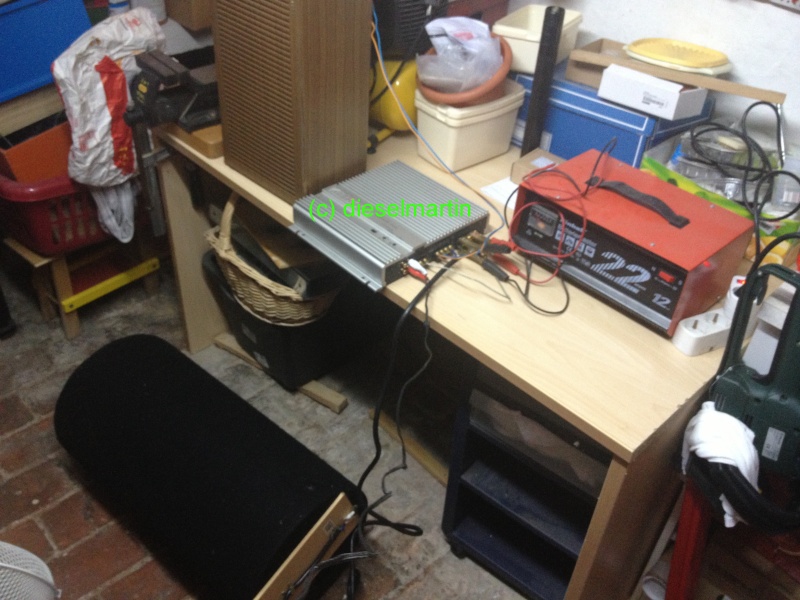

Post26-04-2013, 9:07    Subject: Operating the RCD 300 externally Quote
Another important question:
Do the control units handle operation with such a combined heat and power system?
http://www.baywa-baumarkt.de/out/pictures/generated/product/1/665_665_75/173059_absaar_batterieladegeraet_8a_612volt_01.png
Here, terms like "voltage peaks" and "residual ripple" come to mind.
And for the deliberate destruction of things, those STGs are just too valuable to waste.
Translated on 21-07-2026, 23:37.
Posts: 18138
Post26-04-2013, 9:35    Subject: Operating the RCD 300 externally Quote
Hello Martin,
Here, terms like "peak voltage" and "residual ripple" come to mind.
Correct. It's likely that there is no smoothing filter at all (which makes sense), and the half-wave signals from the rectifier are being used directly.
The devices will probably survive, but malfunctions are quite likely.
Besides the ones I use, there are also regulated power supplies with a voltage of 13.8V and a good output capacity. For example, I have a Peaktech 4613Z next to me (which wasn't expensive): 13.8V / 6A.
Translated on 21-07-2026, 23:38.
Joined: 03/13/2003
Posts: 10121
Location: in der Werkstatt
Post12-08-2013, 9:40    Subject: Operating the RCD 300 externally Quote
OK.
My very old Kenwood KAC 923 amplifier is smoothing everything out internally.
Absolutely no background noise.
It only draws more power when you turn it up than the "power supply" can provide.
