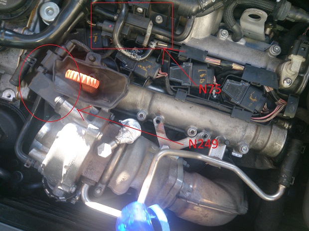

Attached are a diagram of the boost pressure curve and some pictures of the engine.

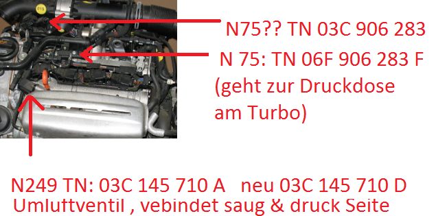

My current problem is that I don't yet understand the valves. It seems there are two N75 valves, but what does the second one control?
A general overview of the TSI technology can be found in Volkswagen's self-study program SSP 359 (simply search for it on Google).
N75 (Turbo pressure sensor) Part number: 06F 906 283 F <- Currently installed.
(supposedly replaced by part number 03C 906 283 A)
N75 ?? TN: 03C 906 283
(wurde getauscht aber was regelt es? Es sitzt eine kleine schwarze Unterdruckdose daran aber wohin führt diese? It is common.
N249 TN: 03C 145 710 A (new version 03C 145 710 D)
(WSL is 03C 145 710. It has been installed, but I have NOT yet verified it. Source regarding new TN http://www.golfv.de/150975-abschaltventil-turbolader-n249-mech-fehler-selbst-getauscht-in-20-minuten.html).

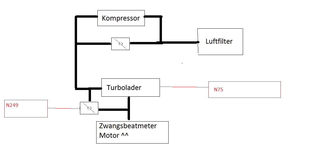

I'm attaching the following images to help you understand the boost pressure curve without a turbocharger (LLK).
As I see it now, both the N75 and N249 sensors could be faulty. It's even possible that the bypass valve on the compressor isn't opening, which would mean the turbocharger isn't getting enough air.
What's the best way to check something without having to order every single little thing?

Here are a few initial remarks. There is only one N75 valve, which is used to control the opening of the wastegate on the turbocharger.
edit: The N249 component is used to dampen the boost pressure regulation when the throttle valve is closed (****).
Since the problem occurs even under partial load conditions, I would start by investigating the behavior of the boost pressure of the supercharger (G5839) and the intake manifold pressure (G319). (Please forgive me for referring to the supercharger as a Roots blower icon_wink.gif).

What does the second solenoid valve control, specifically the small black pressure sensor located behind the motor?
Dient das N249 nicht auch als Bypass für die Kompressor Luft? Oder läuft die Luft ständig durch den Turbo? Kann ich das N249 nicht einfach Rausbauen, Kunstofftüte darüber stülpen so einbauen und eine (wirklich nur eine!!) Runde drehen ob der Turbo dann Druck macht oberhalb der 3400 umin Marke? So könnte ich das N249 als Übeltäter ausschließen bzw. Entlarven.....
Es gibt laut VW einen Bereich wo Rootgebläse (Kompressor) und Turbo sich überschneiden, daher nehme ich an das der Fehler gar nicht am Rootgebläse zu suchen ist, sondern es auch dort zu einen unerwünschten Regelkreisverhalten aufgrund des fehlenden Turbodruckes kommt. Die von dir genannten Sensoren G5839 und G319 finde ich in den Messwerten? Gibt es online Infos dazu wo diese hardwareseitig Sitzen? Zfor understanding.

Regardless, we can first check if the valves, flaps, etc., of the air distribution system are mechanically sound.
That's where I would start looking. The control valve J808, which regulates the airflow to the compressor/turbo, should be accessible through the measurement data blocks.
It reliably shuts off the compressor from the airflow at 3500 RPM; for further improvements, consider turbocharging.
Then it would be necessary to ensure that the recirculation valve closes properly.
If both are okay, then the only remaining possible cause for the lack of boost pressure is likely the turbocharger, including its wastegate.

I would like to mechanically test this valve; how is it controlled?
Perhaps the "second N75" is located near the vacuum and pressure sensor (?), where you can see "complete TSI engine" in the upper part of the image?

N75 ?? Part number: 03C 906 283 is new.
I would like to know what this valve with the small plastic vacuum chamber controls? Does anyone have any idea? Could it possibly be the flap J808?
Part number N249 TN: 03C 145 710 A has already been superseded by the new version 03C 145 710 D.
Works perfectly, tested.

- The control valve J808 is controlled by the MSG (Main System Controller) to regulate the pressure provided by the compressor. Therefore, there is an actuator motor present, but no pneumatic control system.
- There is only one N75 valve, which is used for overboosting the wastegate control. The pressure regulation via the feedback loop consisting of the pressure sensor and the wastegate is overridden by this valve.

And what controls the second solenoid valve, which I'm not allowed to call N75 (even though it essentially functions the same way), because you correct me every time? It controls a plastic pressure sensor using vacuum, and I can't find it in SSP 359.
I've asked this question many times now, but I haven't received an answer yet.
The performance issue has been resolved!
N75 is dead and has been replaced.
Old part number: 06F 906 283 F <- Originally installed.
New part number: 03C 906 283 B
When you call Volkswagen, they will actually try to sell you the old 06F 906 283 F part again! Therefore, it is essential to specify the frame number when searching for the part; otherwise, they will find the new one. This system is really frustrating...
The current price is still only €40.88, but it will probably become more expensive icon_wink.gif.

And what controls the second solenoid valve, which I'm not allowed to call N75 (even though it essentially functions the same way), and you correct me every time? It controls a plastic pressure sensor using vacuum, and I can't find it in SSP 359.
I have asked this question many times now, but I haven't received an answer yet.
The first image in your initial post has low resolution, so it's difficult to see what you're referring to. However, the upper part is likely either the control module for the mechanical supercharger or the valve for the swirl flap control. The lower part is the boost pressure control valve.
Are the two "valves" actually the same? Where do the connections from the valve in your first picture go?
