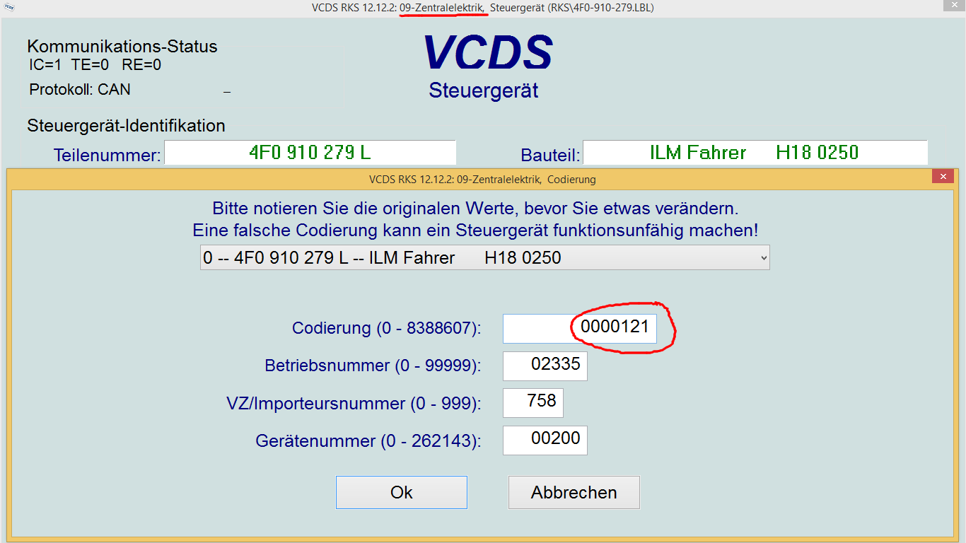

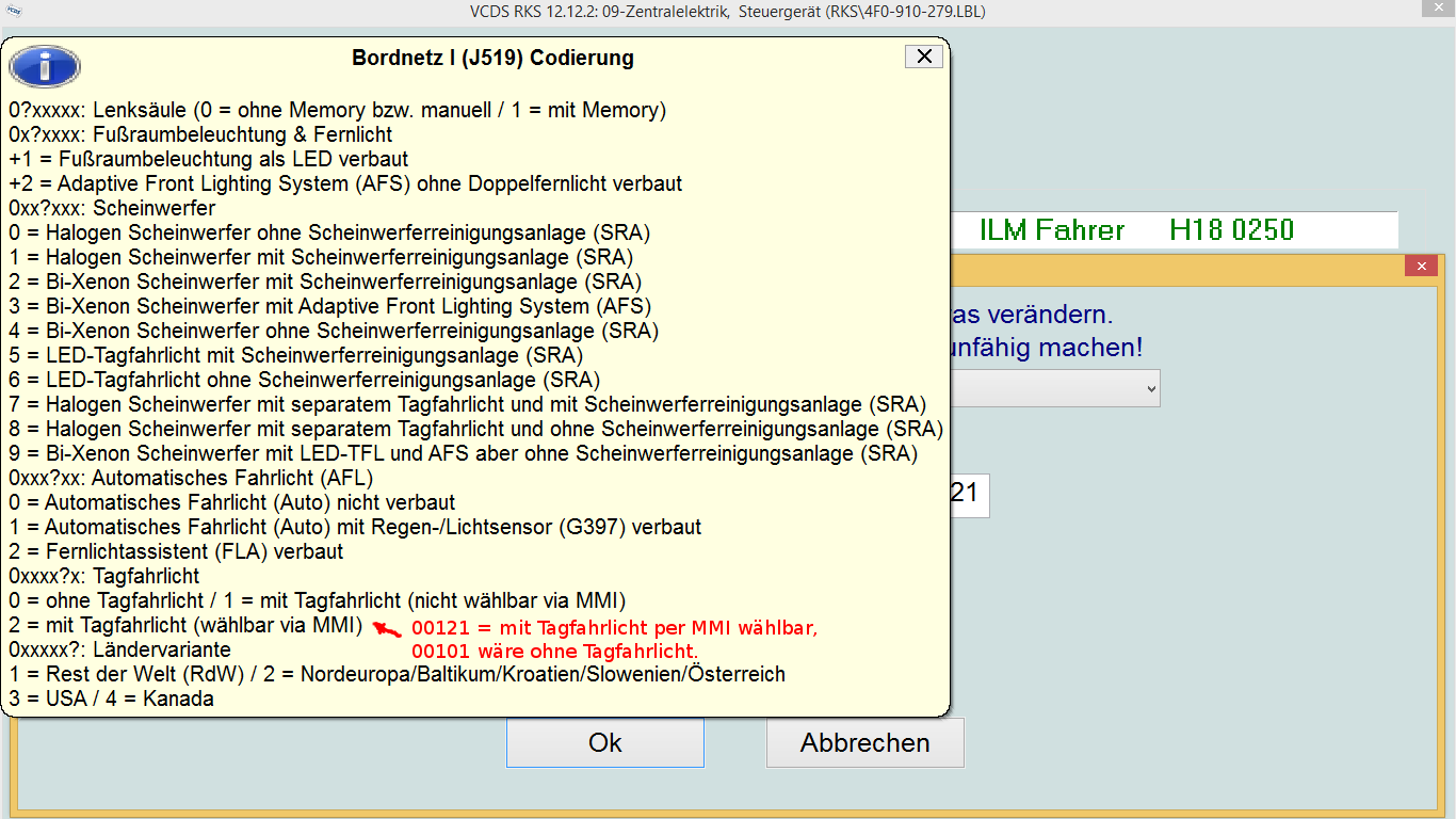

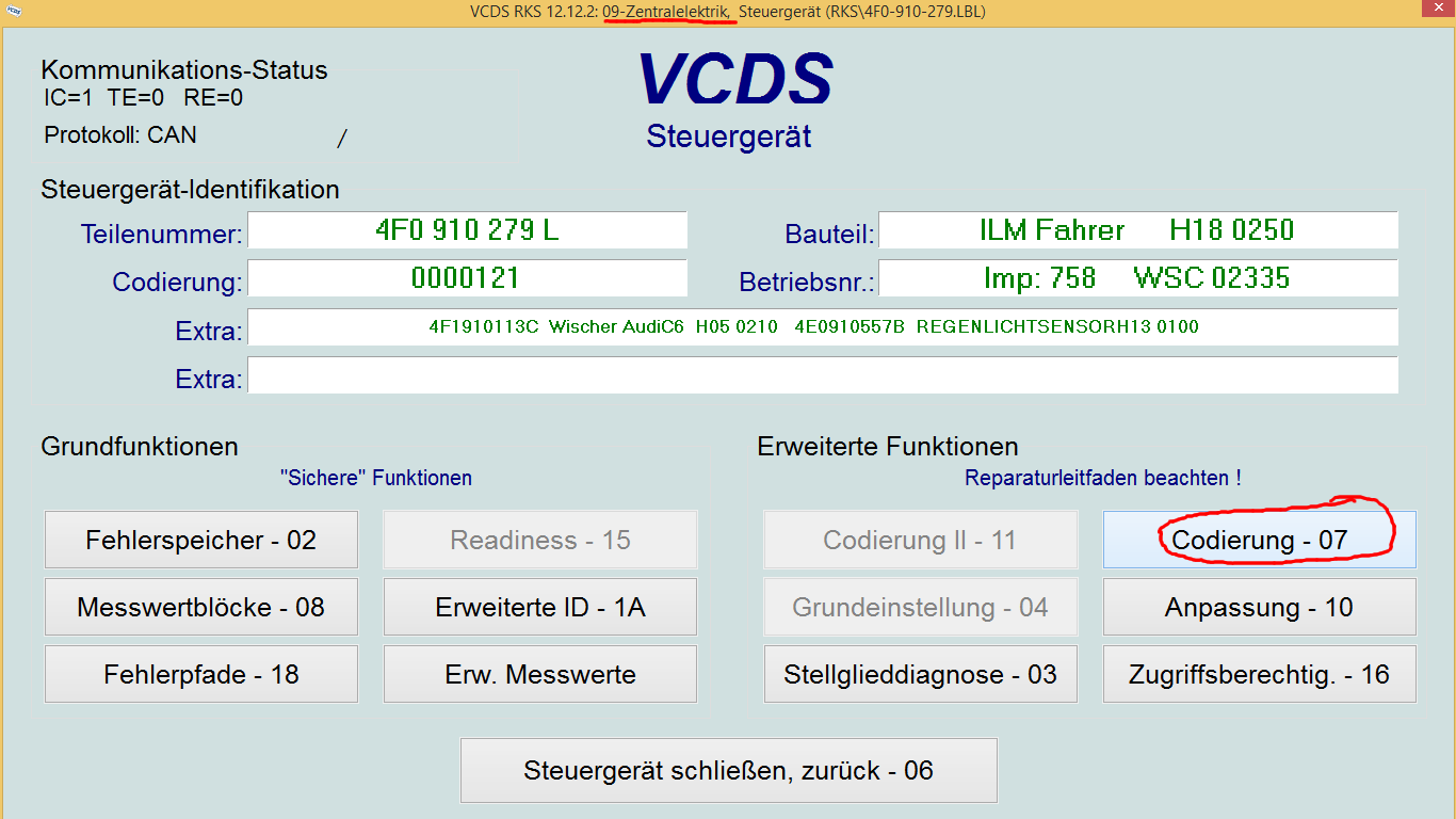

With VCDS, it is possible to activate the daytime running lights in many vehicles from Audi, Seat, Ĺ koda, and Volkswagen. This is usually done by coding the body control module/central electronics (control unit address 09).
The attached screenshots show the activation of the daytime running lights as an example, using the VCDS diagnostic software on an Audi A6 4F.

 Bordnetzsteuergerät (Zentralelektrik)

 Funktion "Codierung"

 VCDS Codierungsinfo
