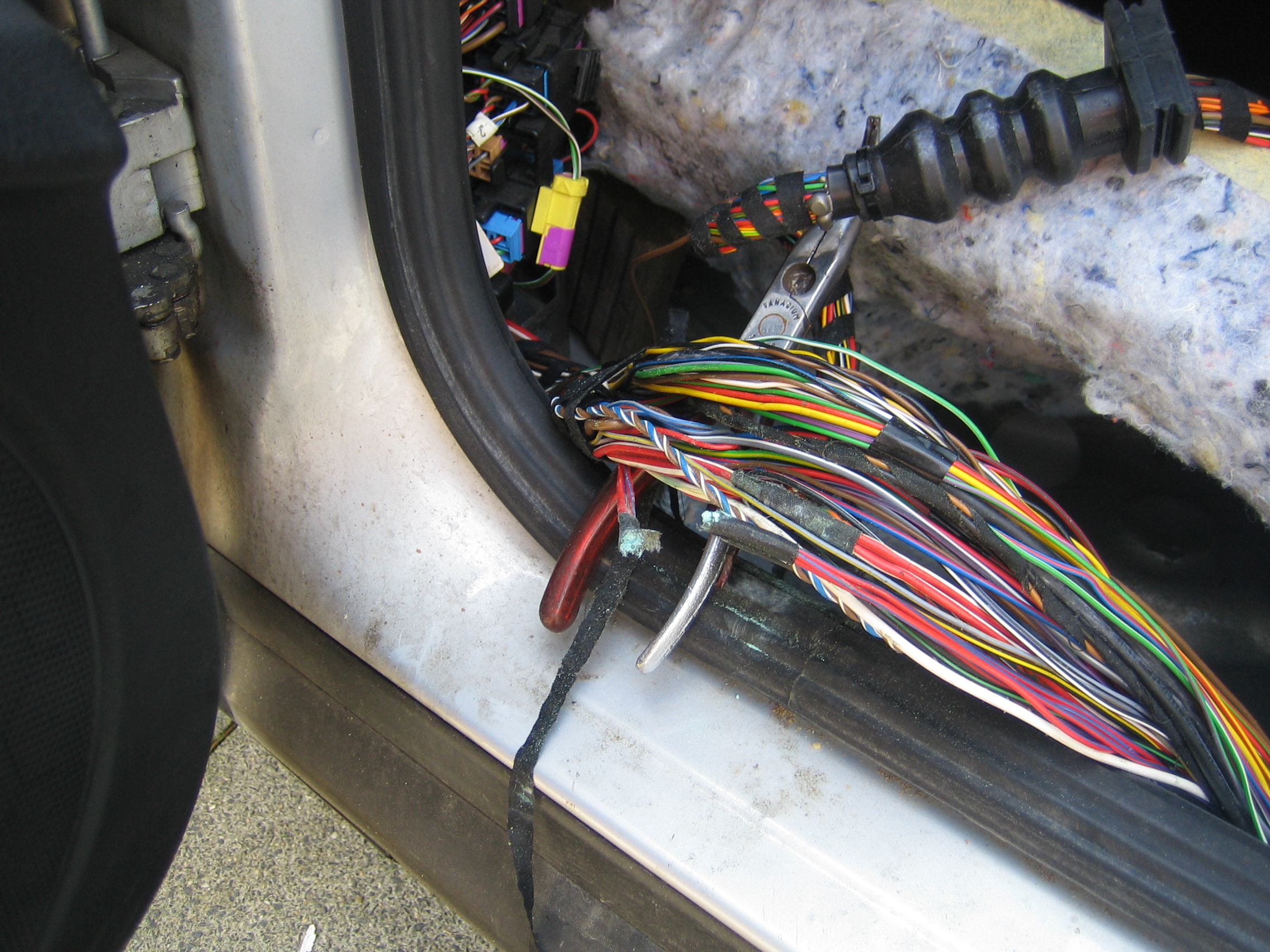

Quote: | | And how do you repair something like that in the engine compartment? It should be watertight. |
Despite all the naysayers, I'm doing it the old-fashioned way (soldering  ) and using heat shrink tubing.
with something like that  :
http://www.musikhaus-korn.de/de/tesa-4186-Zumbelband-19mm-schwarz-25m.html?pid=2&gclid=CKWg_9jnl74CFaoewwodP0gA8Q
Complaint rate --> = 0.
What others think is their problem – and I don't want to discuss it. My experience proves me right – this method has worked perfectly here for what feels like 50 years, whereas I've had to fix countless crimped connections that have failed. Even in places where there's no water.
| Description: |
| Repairing Wiring Harnesses (Trunk, etc.) |
