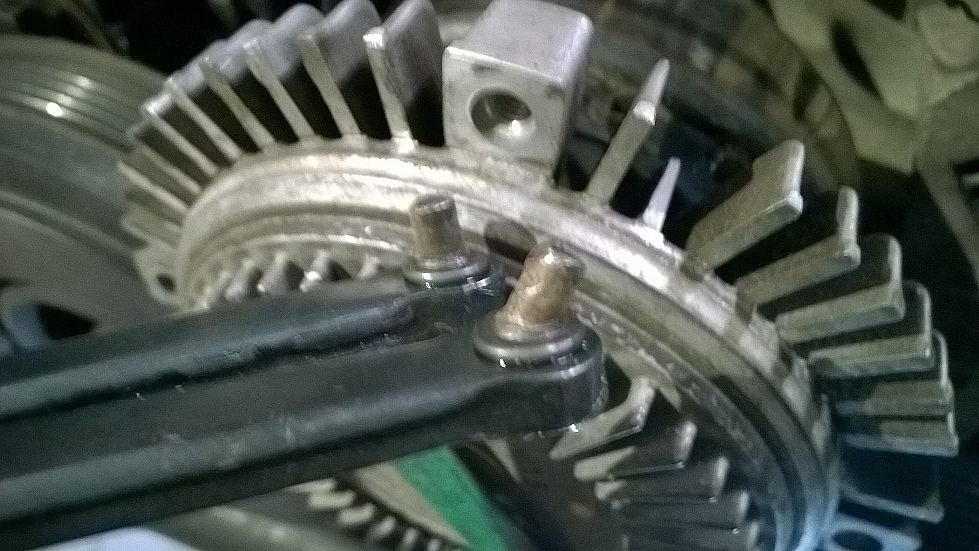

There's nothing I can do; I can't get the 32mm nut off the ViscolĂŒfter (blower motor) (rotation direction: clockwise). In the process, I broke the 3212 retaining clip (see picture).
Does anyone have any ideas before I have to resort to using the torque wrench? The stock is almost empty, and since the timing chain is being replaced, I also want to replace the flange shaft bearing. I'm a bit stuck right now.

 Oops... it should be opened counter-clockwise!
Tip: Use a hot air gun or a small soldering iron to get it off!

Great. I was told 'right-hand thread' because it's a left-hand thread...
Luckily, my son emptied the butane torch, probably to use it for his silly shisha coals.

Hmmmm, which car are we talking about here? Isn't there an Allen screw on the back, near the water pump? If so, the Allen screw is opened to the LEFT. If there's a thick nut behind the fan, it's opened to the RIGHT, I hope I'm not mistaken  .

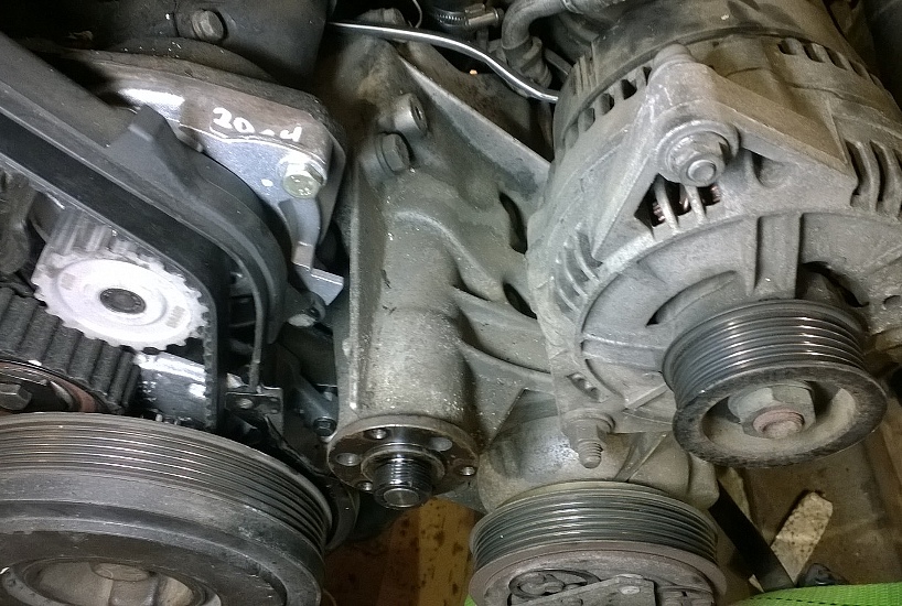

Nicht geirrt! 1000 Dank.  Linksrum ging sie auf. Ist ja auch die Drehrichtung des Visko. Etwas WD40 und warmgemacht. A6 C4 TDI Quattro. MKB = AEL
So nun nicht genug der Probleme... I would like to.
I need to replace the bearing. But how do I get to the bearing?
Does the entire bracket need to be removed for the Klima and Lima components? Will it be accessible then?
Best regards, Kai.

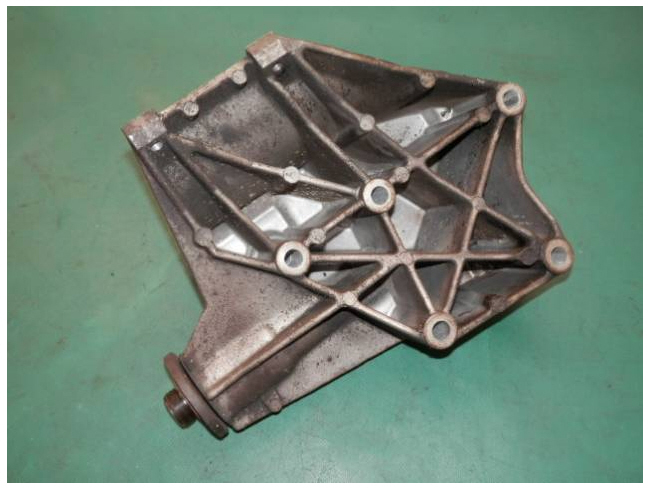

Here's what the carrier 046903143C looks like from the bottom... (image)
It seems like this is only available as a complete set with storage. Hmm.

Depending on the VIN, there are likely two variants: one with a fitting and one without.  If there is no fitting, a single bearing is also not offered. }

Remove it with a puller and press it back in?
Translated on 25-08-2026, 23:20.

hm...
The plate, including the thread, is a single piece and appears to be pressed onto the shaft. Is it possible to remove it?
I'll need to get a puller.
But then the storage unit needs to be removed. Has anyone ever disassembled one of these before?
Best regards, Kai.

kmrlange Guest
26-07-2014, 11:14 Subject: Viscous Fan Screw Stuck / Jamshed Defective |
Quote |
I can't get to it with the puller. The flange won't come off the shaft. I've even tried heating it up.
So, NEW...
It appears that model 046 903 143C has been replaced by model 046 903 143 D and costs a hefty 389 EUR plus VAT.
Does anyone have good deals on spare parts from the VAG group?
Best regards, Kai.

Herbert Profi-Schrauber
Joined: 06/22/2005 Posts: 4627 Karma: +1342 / -0
26-07-2014, 12:32 Subject: Viscous Fan Screw Stuck / Jamshed Defective |
Quote |
"Can't the flange and shaft be pulled out together? They don't necessarily have to be separated. You would need to create a device that rests on two bolts through the holes and against the flange, and then pushes the latter outwards. There's probably a needle bearing inside, which might be available as a standard part. Before pulling it out, measure the insertion depth and the distance to the housing!"
