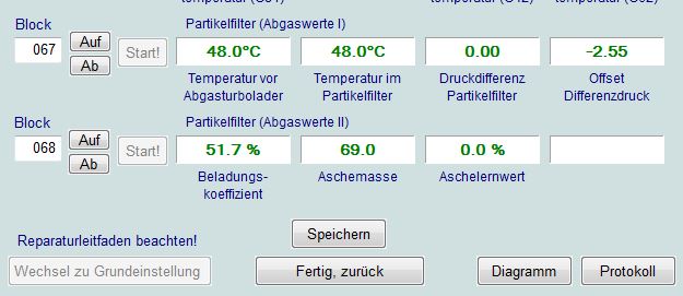

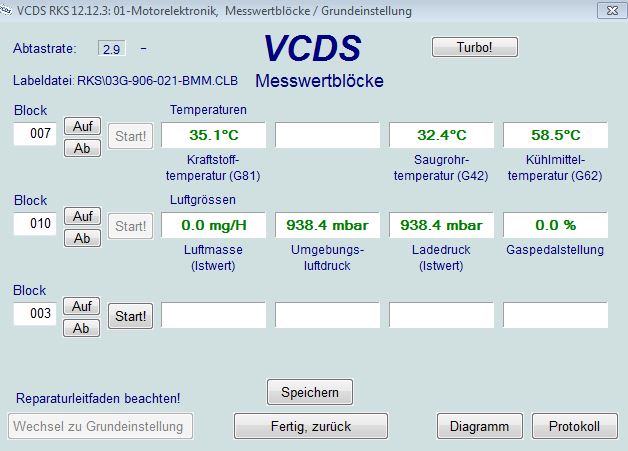

Post26-09-2014, 18:50    Subject: 2.0 TDI engine failure - BMP Quote
I immediately reconnected the AGR valve, but the engine dies after about 5 seconds or less, which prevents me from logging any data.
Attached are the other measurement readings (engine off, but still some residual heat).
The DPF light only came on while driving.
PS: The actuator test for the EGR system goes up to a maximum duty cycle of 30%, is that acceptable?

Posts: 18117
Post26-09-2014, 21:16    Subject: 2.0 TDI engine failure - BMP Quote
According to measurement block 68, the DPF is completely clogged, and there may also be another blockage in the exhaust system.
Check if the engine is running normally when you slightly loosen the exhaust pipe from the turbocharger.

Posts: 18117
Post30-09-2014, 12:06    Subject: 2.0 TDI engine failure - BMP Quote
It's possible that the AGR (Abgasrückführungssystem - exhaust gas recirculation system) is also not working correctly, but that alone won't help you.
Because of the ash mass in the DPF:
dieselschrauber wrote:
Wird der Maximalwert von 60 g erreicht bzw. überschritten ist eine Regeneration nicht mehr zulässig und der Partikelfilter muss ersetzt werden.
Scheduled is:
