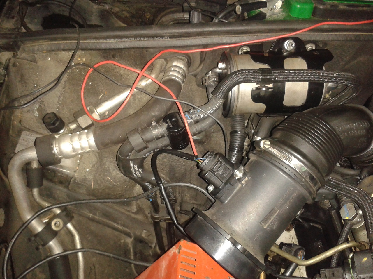

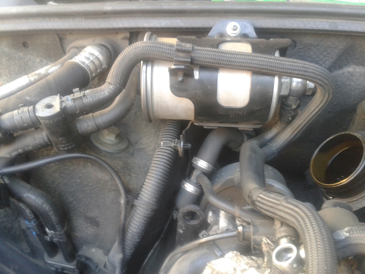

mitch79
Joined: 06/05/2011 Posts: 12 Karma: +0 / -0 Location: Weil der Stadt 2005 Audi A4 Avant Premium Support
24-11-2014, 20:15 Subject: Fuel system bleeding - Audi A4 3.0 TDI BKN |
Quote |
Hello Auto Service,
"Incoming and outgoing are not mixed up. I just took another photo and compared it to the condition before the renovation."
Nothing gets to the injectors, and I've already loosened the connection.
How long would it take the HD pump to completely fill the empty rails?
