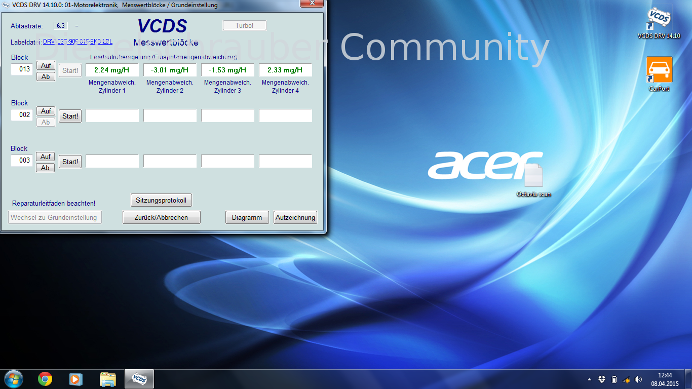

| Description: |
| PD werte nach kurzer fahrt (90 grad wasser) |

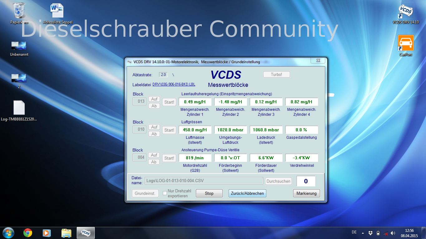

| Description: |
| PD werte vor kurzer Probefahrt |
| File size: |
1.1 MB |

Processed loader.
Chip tuning.
That's where I would start.
Where the deviation of 3.xx mg/r is not really ideal  .

Autoservice Profi-Schrauber
Joined: 04/14/2012 Posts: 2130 Karma: +99 / -0 Location: NĂ€he DĂŒsseldorf
08-04-2015, 16:05 Subject: 2.0 TDI BKD: Severe Engine Misfire During Acceleration |
Quote |
If the engine's hardware â compression, camshaft, and lifters â is all in good condition...
My suggestion is that the problem might be related to leaky pressure diaphragms (PDs).
08-04-2015, 17:07 Subject: 2.0 TDI BKD: Severe Engine Misfire During Acceleration |
Quote |
Quote: | PDs habe ich beim Kopfwechsel neu abgedichtet, oder meinst du intern, quasi das eins (ich vermute das am 2. Cylinder) Dripping?
I read that, but I would only be sure if I had done it myself.
If this defect did not exist before the change in the central system (ZK), or if the peripheral devices (PDs) are still the old ones, then...
I personally...
Expand.
-- have it checked, if not already done, and/or...
-- replace the seals and reinstall them. I would also swap the pressure dividers among themselves.
Specifically, swap the functions of both inner pressure sensors (PDs), so that cylinder 2+3 are connected to cylinders 1+4 and vice versa. If the error persists, you can draw conclusions based on the LL (likely referring to a control or regulation system) behavior: observe whether the error values or positive/negative readings shift with the swap.

Herbert Profi-Schrauber
Joined: 06/22/2005 Posts: 4614 Karma: +1333 / -0
08-04-2015, 21:26 Subject: 2.0 TDI BKD: Severe Engine Misfire During Acceleration |
Quote |
Just for the record,
What was the engine temperature before the test drive? LLR values are not very informative when the engine is cold. The ignition timing is too advanced.
08-04-2015, 23:15 Subject: 2.0 TDI BKD: Severe Engine Misfire During Acceleration |
Quote |
Nö, bei den Werten "vor kurzer Probefahrt" nicht. What is short?
