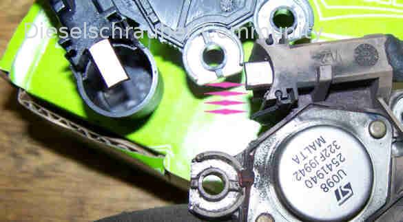

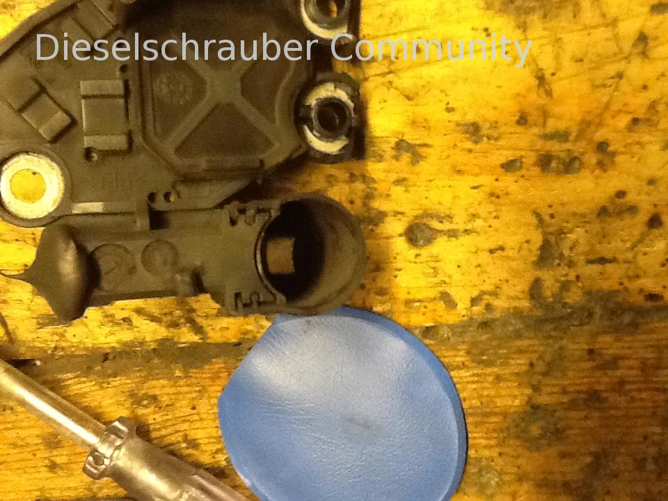

Here are some pictures of Valeo regulators.
| Description: |
| Der Lichtmaschinenregler ist aus einer 120A Passat Lima mit 254tkm auf der Uhr.Die vordere Kohle geht ja noch gemessen an der Laufleistung. Aber die hintere ist fast nicht mehr da. |
| File size: |
18.89 KB |
| Viewed: |
2444 times |
| Description: |
| Der Lichtmaschinenregler hat lediglich 125tkm auf der Uhr. Zwar beide Kohlen gleichmässig abgenutzt,aber gerade mal 5mm noch vorhanden. |
| File size: |
140.92 KB |
| Viewed: |
5319 times |
Passat Variant BGW 2005
Translated on 21-09-2026, 6:44.

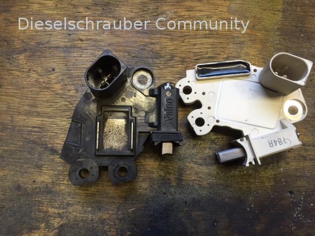

Hello Steffen,
"The instructions and pictures were really helpful, thank you very much. Disassembling the regulator was easy after that. The carbon brushes still have 6mm of material left, so they are probably worn out. Given the mileage (156,000 km), should I only replace the regulator and carbon brushes, or the entire alternator? We live in a rural area and rely on the car, which is why I'm asking."
Have a nice evening.
Best regards, Holger.
| Description: |
| Defekter Lichtmaschinenregler |
| File size: |
305.98 KB |
| Viewed: |
2245 times |
Passat Bj. 2014, MKB CAYC
Translated on 21-09-2026, 6:45.
| Back to top |
Profile PM |
Steffen W Profi-Schrauber
Joined: 07/05/2008 Posts: 1276 Karma: +104 / -0 Location: Altenburg
31-08-2015, 7:09 Subject: Passat 3BG Fault Code Generator for Mechanics |
Quote |
Nonsense, leave the clutch mechanism alone if there's nothing else wrong. There are no noises that sound like a bearing failure, and the belt isn't wobbling, which would indicate a faulty freewheel. And even the freewheel can be replaced individually.
The carbon length of 6mm is still within the acceptable range, so that was probably not the cause of the display message. However, since the wear limit is 5mm, I would recommend replacing it in your situation. Part numbers for this component that can be found in stores are, for example:
Hella 5DR 009 728-251, Vemo V10-77-1019, or VW 038 903 803 K. I don't know where you buy your parts, but your dealer can use these numbers to find the correct item.
