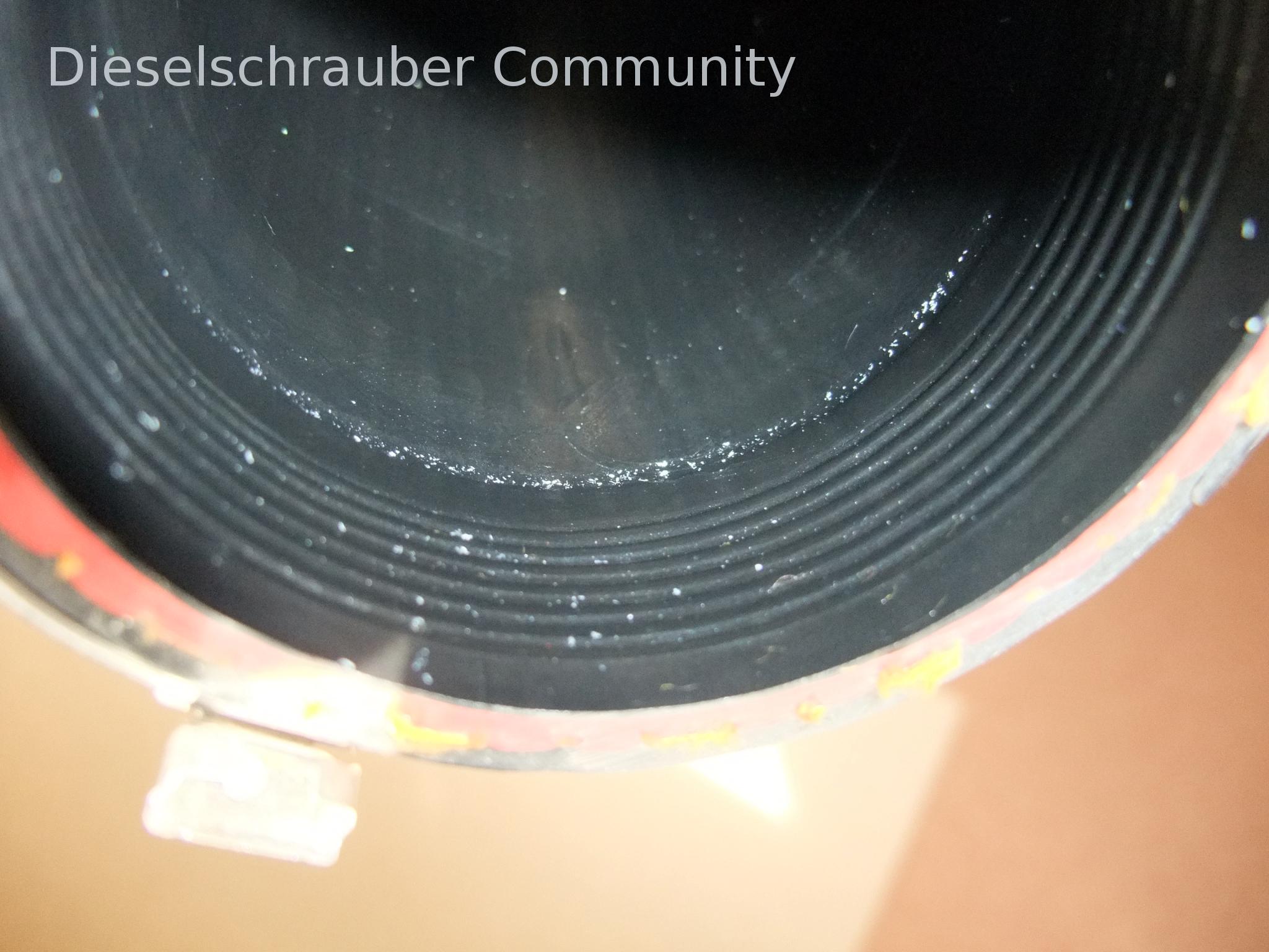

In the Polo WRC, I found a significant amount of small, greenish-gray particles in the pressure hose connecting the turbocharger to the intercooler, at a mileage of 2400 km, as shown in the attached image.
The crumbs don't shine and they don't feel like metal; rather, they feel like some kind of plastic.
The intake manifold from the air filter to the supercharger is clean. The supercharger is running smoothly without any whistling or whining noises, starts boosting around 2000 rpm, and the normal power output is present.
The posts in another forum (which is not publicly accessible) led me to believe that the most likely explanation for the issue is mold release agent used in the manufacturing of the compressor housing.
If that were the case: What does that mean for my engine, which now has almost 300,000 kilometers (or miles)?
Based on my estimate, he has already ingested so much of that substance that the remaining amount distributed in the intake manifold will likely have no further effect on him.
Should I, just to be on the safe side, thoroughly clean the intercooler system, including the front mount intercooler (FMIC), as much as possible (instead of having the work done under warranty, which might not be done very well)?
To what extent could the sand have made him a permanent oil addict? See https://community.dieselschrauber.org/en/viewtopic.php?t=28024.

To what extent could the sand have turned him into a permanent oil drinker? See https://community.dieselschrauber.org/en/viewtopic.php?t=28024
An endoscopy of the cylinder walls can provide clarity. Scratches caused by hard foreign objects are very easily visible during this procedure.

Finesand in the intake air path?
Definitely not.
The manufacturing process simply doesn't allow for that.
To what extent could the sand have made him a permanent heavy drinker?
Once the particle size and hardness are determined, we can say more about it.
Since the particles in the photo appear to be very fine, it's probably not the case.
Definitely not.
That is not allowed by the manufacturing process.
I would think so too.
But in another forum, the owner of a turbocharger specialist company
mentioned that I had actually experienced something similar once with a brand new turbocharger, where there was an inclusion in the compressor housing. The customer then wanted to install the turbocharger, but suddenly sand started pouring out of the compressor housing
Another user there:
In the past, real molding sand was used, but nowadays there are also plastic granules that fulfill the same purpose. I think it might be something like that.
"Formed granules seem to me now the most likely explanation for what is actually inside my charge air duct: because of the completely uniform (non-sandy) color of all the particles, without any metallic sheen icon_rolleyes.gif".

Nonsense!
You seriously believe that the negative form survived multiple washing processes, several machining operations, and further washing processes? It's more likely that there are metal shavings inside.
Okay, so you also have to believe in Santa Claus and the stork that brings children to their parents. icon_rolleyes.gif
I assume it's dried-out assembly paste. This stuff dries out, turns gray/white, and is completely harmless when it passes through the engine. It's frequently used in factories to make the assembly of rubber and plastic parts "smoother." After all, things need to go quickly...

Even though it contradicts all known casting and manufacturing processes, a replacement glow plug that I was installing in my Passat TD came out of the packaging with fine white sand inside (it was a VW part, under warranty, at the workshop). It was immediately returned.

Okay, so from over 20 years ago... Back then, there was also a 1000km oil change service... Why, I wonder? I've seen metal shavings in the oil more than once during those oil changes.
And sand doesn't necessarily have to be molding sand; it could also have gotten in through storage or something similar.

I am referring to an original ET part that was delivered directly from the factory. The storage conditions at VW were certainly just as impeccable then as they are today, only with fewer "Mänätschers" (likely a colloquial term for something).
By the way, the oil change interval for this model was 7,500 km. 1,000 km was a long time ago, like almost 40 years ago, and some of us were still riding tricycles back then.

I still don't fully understand why a new car would be disassembled like that, but it has happened now, and what one thinks about it... well, doesn't really matter (although I also believe that all this tinkering could potentially cause significant problems in the event of an accident).
But:
I have to disagree with Bertil. My employer builds industrial furnaces, which often includes foundries. In recent years, particularly in the automotive industry and especially among German manufacturers, there has largely been a shift towards inorganic binders. This has been accompanied by almost biblical problems during the casting process. Of course, it's nice that the new VW foundry is completely white and no longer the leaky mess it was five years ago, but that's about all the advantages there are (or were). The turbocharger probably won't be coming from Germany either. Regarding the cleaning of products after being removed from the mold, I've seen a lot, so theoretically, it is possible.
Okay, if I were to go back to the main topic and examine the charge air hose, I have a feeling that these "foreign objects" are mainly located in the sealing area, and that's how they got there during the assembly process, where they still are now. That makes sense, because everything else would have been blown out. So, I'm back to Bertil and his assembly aid.
"Foundry sand" is naturally different from "play sand." In fact, it's a very scarce resource (whether you believe it or not). Grain size, surface area, and purity all play a role. I've seen every shade of color imaginable. However, the engine wouldn't care whether it was foundry sand or sand from an improper storage location. The problem is: if it were foundry sand from the repeatedly processed metal part of the turbocharger, it would have long since disappeared and wouldn't be found in the seal...

Do you seriously believe that the negative form survived multiple washing processes, multiple machining operations, and further washing processes? It's more likely that there are metal shavings inside.
It's conceivable that this could have happened – perhaps when the negative image wasn't entirely stable, and a few "grains" from a thin aluminum layer were obscuring it, only to flake off later.
Honestly, don't worry about a few crumbs. You should see what the intercooler intakes look like on vehicles that use dry cotton filters (sports air filters). You'll find a kind of "grinding paste" in the quieter areas (hose connections, intercooler, etc.).
These engines, surprisingly, can last well over 100,000 km icon_wink.gif.

matthiasTDI96 wrote:
I still don't fully understand the process of disassembling a new car, but it has now happened, and what one thinks about that...doesn't matter
. I had "only" removed one hose to estimate the amount of oil in the intercooler system - the reason: see my topic on the CDL's oil consumption.
If I were to go back to the topic and examine the charge air hose, I have the impression that these "foreign objects" are mainly located in the sealing area and therefore came there during the assembly process, where they still are now. That makes sense, because the rest would be blown away. So, I'm back to Bertil with his assembly aid.
This explanation seems most plausible to me so far, also because of the significantly different grain sizes, which are typical for other dried-out materials (window sealant, clay, paints, etc.).
Or could residues of foundry sand or plastic granules have a similar particle size distribution?
The many granules on the sealing surface initially suggest the use of a mounting aid. However, unfortunately, I had already wiped the area directly behind the sealing surface with my finger before taking the photo, and I may have spread some of it onto the sealing surface in the process icon_rolleyes.gif.
(I no longer remember icon_redface.gif whether the sealing surface was clean beforehand.)
To be honest: don't worry about a few crumbs. You should see what the intercooler intakes of vehicles running with dry cotton filters (sports air filters) look like. In quieter areas (hose connections, intercooler, etc.), you find a kind of "grinding paste" there.
My worst-case scenario thoughts also go in the direction of clogged crumbs in valve seat seals: If a valve doesn't close properly because of this, apparently exhaust gases can leak past, and it could warp... or am I wrong about that?
