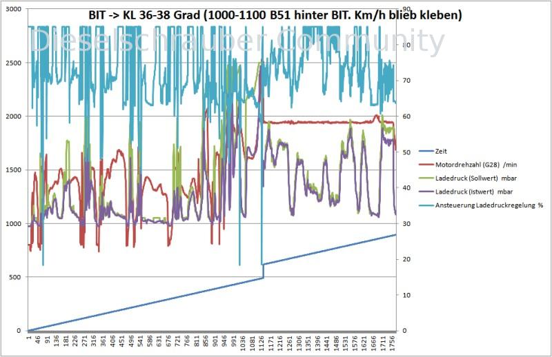

dieselmartin Profi-Schrauber
Joined: 03/13/2003 Posts: 10121 Karma: +29 / -0 Location: in der Werkstatt 2007 Volkswagen Passat Premium Support
07-07-2015, 8:08 Subject: LMM vs. BMR: Which is Better? |
Quote |
... he should earn more because he wants more.
He is clearly not reaching the target pressure.

Profile PM Garage |
dieselschrauber Administrator
Joined: 04/12/2002 Posts: 18135 Karma: +804 / -0 Location: St.Gallen 2018 Volkswagen T6
07-07-2015, 8:11 Subject: LMM vs. BMR: Which is Better? |
Quote |
Well, it looks like there's a vacuum leak or the charger is stuck on the VTG...
Translated on 28-09-2026, 21:17.

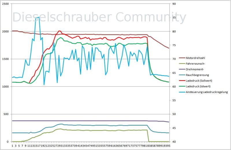

07-07-2015, 8:21 Subject: LMM vs. BMR: Which is Better? |
Quote |
What do you mean by "the charger is sticking out"?
I'm puzzled that he usually adjusted the settings perfectly in that system.
Even in that "state," the smoke level was still high enough.
The top 70% of the N75 should not have been opened, even by VTG.
Unfortunately, I didn't log the waypoint.
While driving, there were no noticeable issues; the car easily reached and maintained a speed of 140 km/h.
Here's an overview - I didn't notice the "boost pressure" error until later.
The log was self-driving... so I couldn't really think deeply or carefully about what I was doing  . I just wanted to make use of the 150 km and the 36-38 degrees.
07-07-2015, 8:25 Subject: LMM vs. BMR: Which is Better? |
Quote |
I made a typo above.
Quote: | | But unfortunately, I didn't log the waymarker. |
It would be a good idea...  However, I would first check all the vacuum hoses.

matthiasTDI96 Profi-Schrauber
Joined: 02/27/2003 Posts: 5886 Karma: +252 / -0
07-07-2015, 8:35 Subject: LMM vs. BMR: Which is Better? |
Quote |
I received a similar log from a 2.0 CR TDI engine belonging to a friend. Like Rainer, I initially suspected a vacuum leak. By using a syringe on the VTG sensor, we were able to identify it as the cause... It's quite a quick check.
Translated on 28-09-2026, 21:20.
