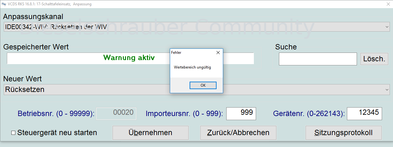

Post12-10-2016, 22:31    Subject: Reset Service Interval UDS Quote
I can't find the channels.

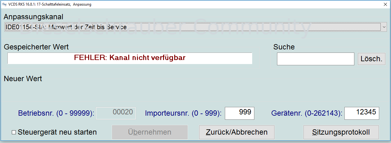

Post12-10-2016, 22:34    Subject: Reset Service Interval UDS Quote
SIA is not available.
