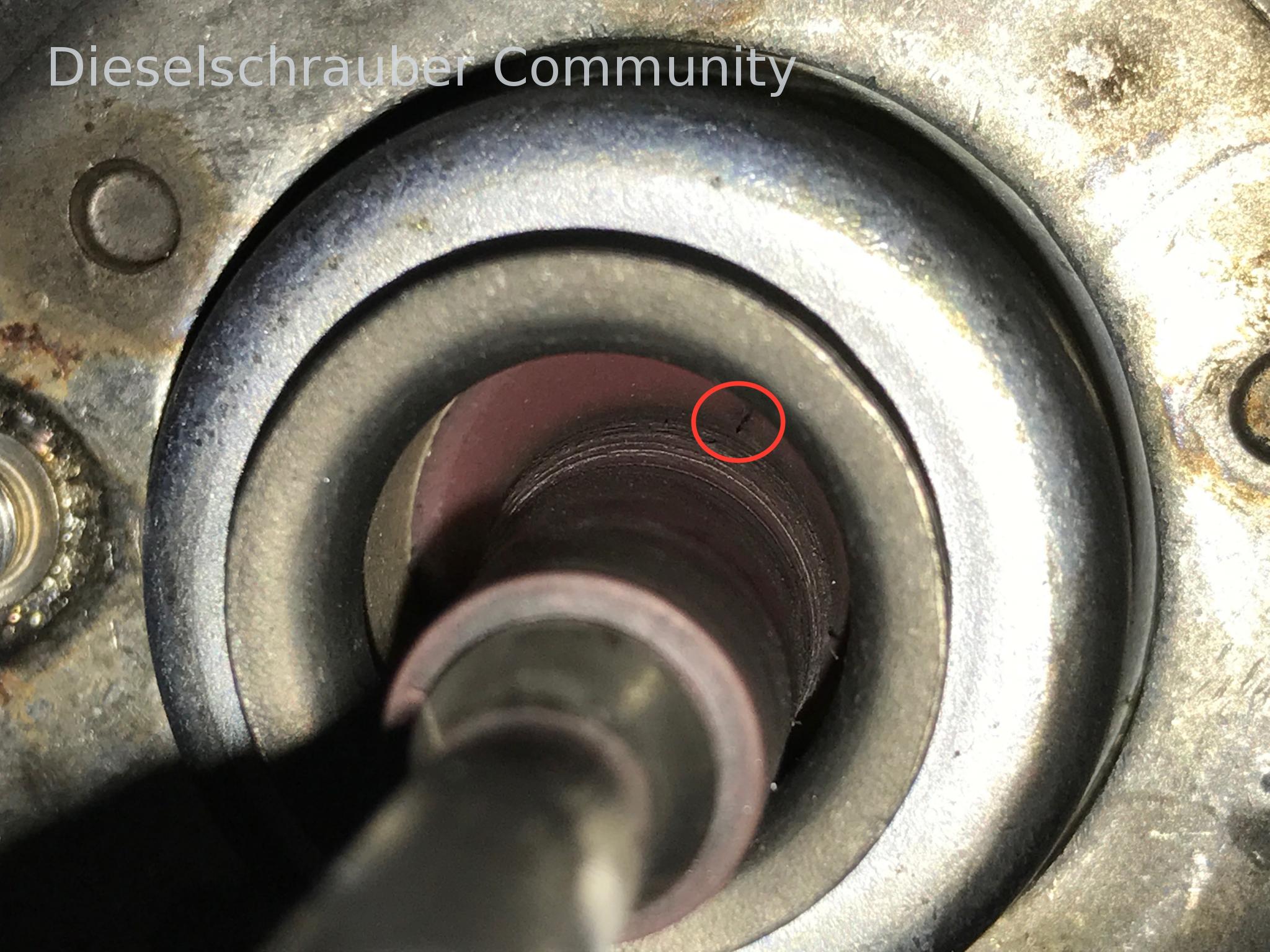

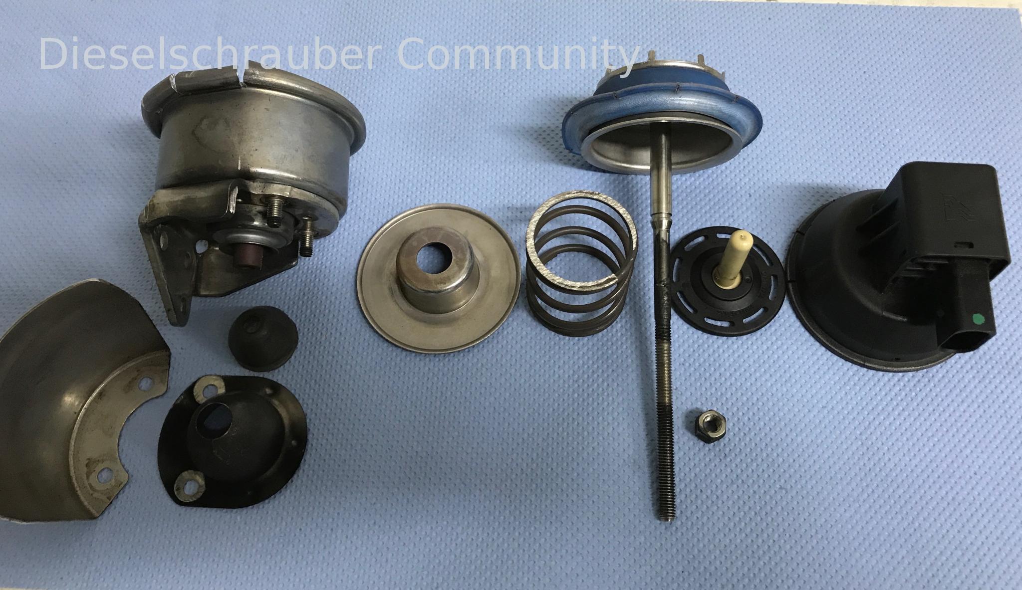

Post03-05-2017, 18:46    Subject: CBBB Error Code: Troubleshooting & Solutions Quote
The pressure sensor has been replaced, and the boost pressure is back. Attached are two photos: one showing the disassembled sensor and its components, and the other showing the actual problem – a crack in the lower membrane.
Best regards,
 Einzelteile Druckdose
 File size:  1.61 MB
 Viewed:  4327 times
 Riss Membran
 File size:  1.75 MB
 Viewed:  1027 times
