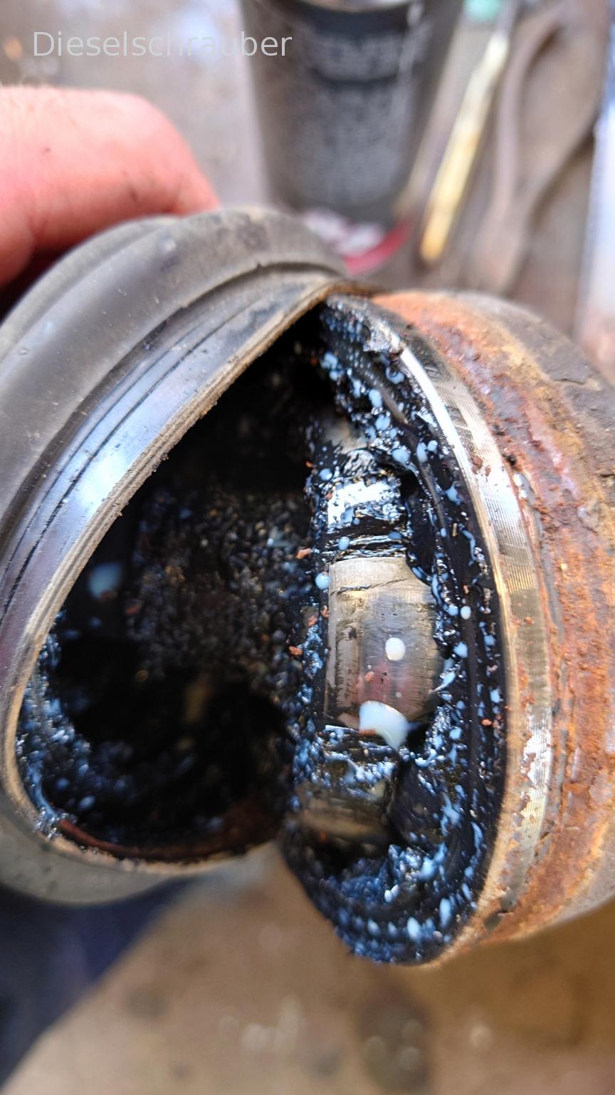

Ultimately, it was just a driveshaft, as you can see in the photo and video. (After disassembly, water leaked out of the threads!)
