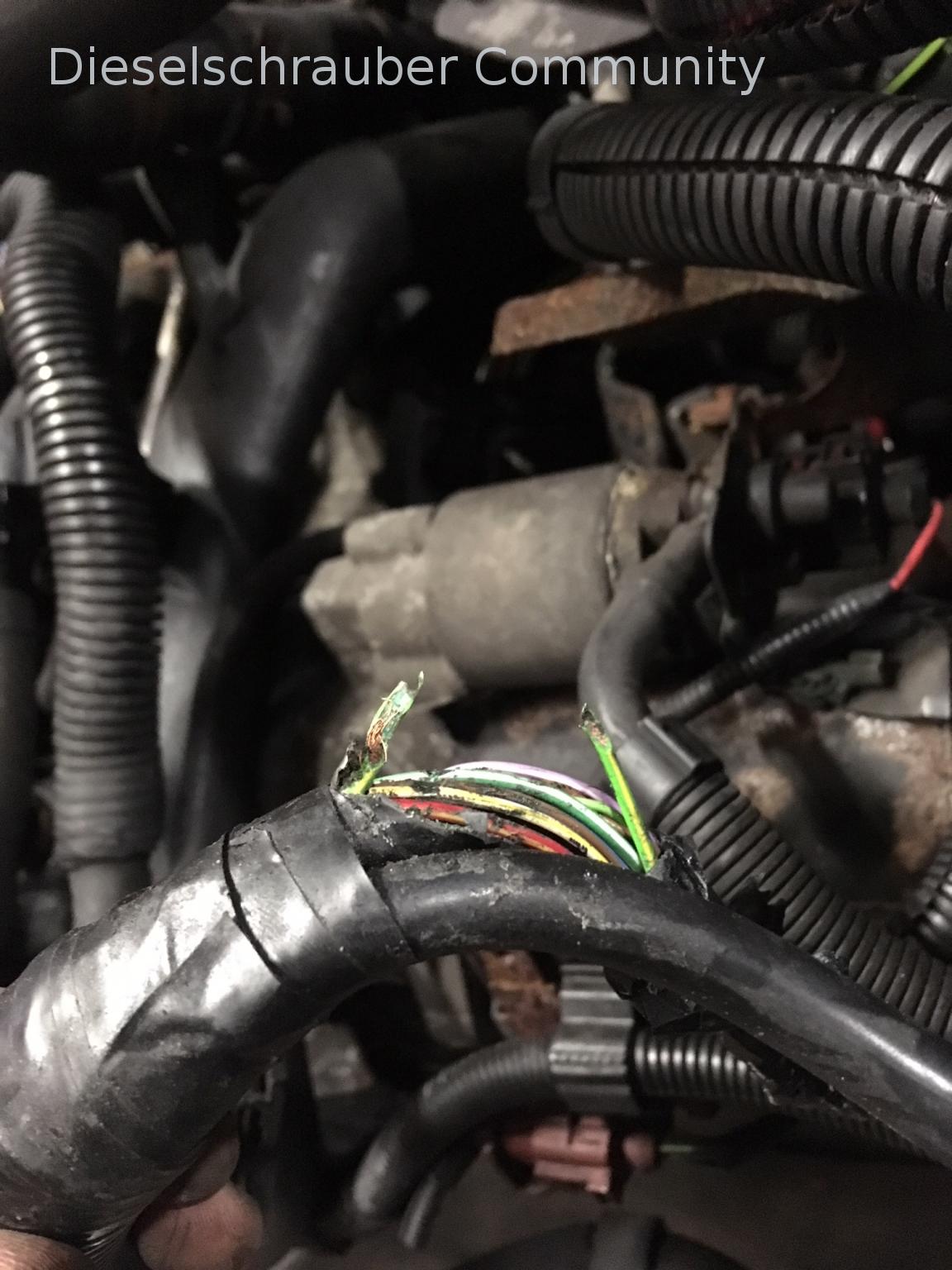

Post24-11-2017, 23:07    Subject: Ibiza 6L Throttle Body: Faulty Signal Quote
Hello guys,
I found the error.
See image for more details.
Thank you for your efforts; the next error is sure to come. icon_smile_thumb_up.gif
Best regards, Julian.
