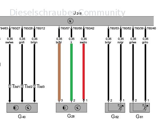

Post19-01-2018, 8:25    Subject: VW Touran: Faulty Crankshaft Sensor - Fixed! Quote
Good morning, I found the error and just wanted to briefly report what caused it.
I measured the G28 sensor on a Caddy with an identical engine to determine what the target values are for the G28.
I measured a voltage of 5V on a cable (purple wire, pin 2) connected to the defective Touran, and I thought that was the supply voltage for the G28. Therefore, I assumed that pin 3 (wire color br/bl) was the switched ground, and pin 1 (sw/ro) was the signal line.
Unfortunately, that's not the case, as I discovered with the current Caddy.
The occupancy of room G28 is as follows:
Pin 1 sw/ro: 5V (continuous), powered by the control unit.
Pin 2 (li): Signal line; however, it also receives 5V when the ignition is turned on, but this voltage is...
Start engine / Run engine on signal from sensor G28.
Pin 3: Switched ground.
The problem was ultimately that the 5V power supply voltage wasn't reaching pin 1. The cause is either a broken cable from the control unit to the sensor, or the control unit is no longer supplying the 5V.
I temporarily took the 5V from the NOx sensor (the wires are located next to each other near the oil filter housing) and connected it to pin 1 of the G28.
Conclusion: The vehicle started immediately, and the error message disappeared.
Here is a section of the circuit diagram.
Thank you very much and have a nice weekend.

Posts: 18128
Post19-01-2018, 9:02    Subject: Touran Crankshaft Position Sensor - Faulty Signal Quote
Excellent resolution icon_smile_thumb_up.gif.

Post19-01-2018, 10:47    Subject: Touran Crankshaft Position Sensor - Faulty Signal Quote
The wiring diagrams at VAG (Volkswagen Group) leave much to be desired. They could indicate on the connectors where the 5V, ground, and signal lines are located. They should take a leaf out of BMW's book.
