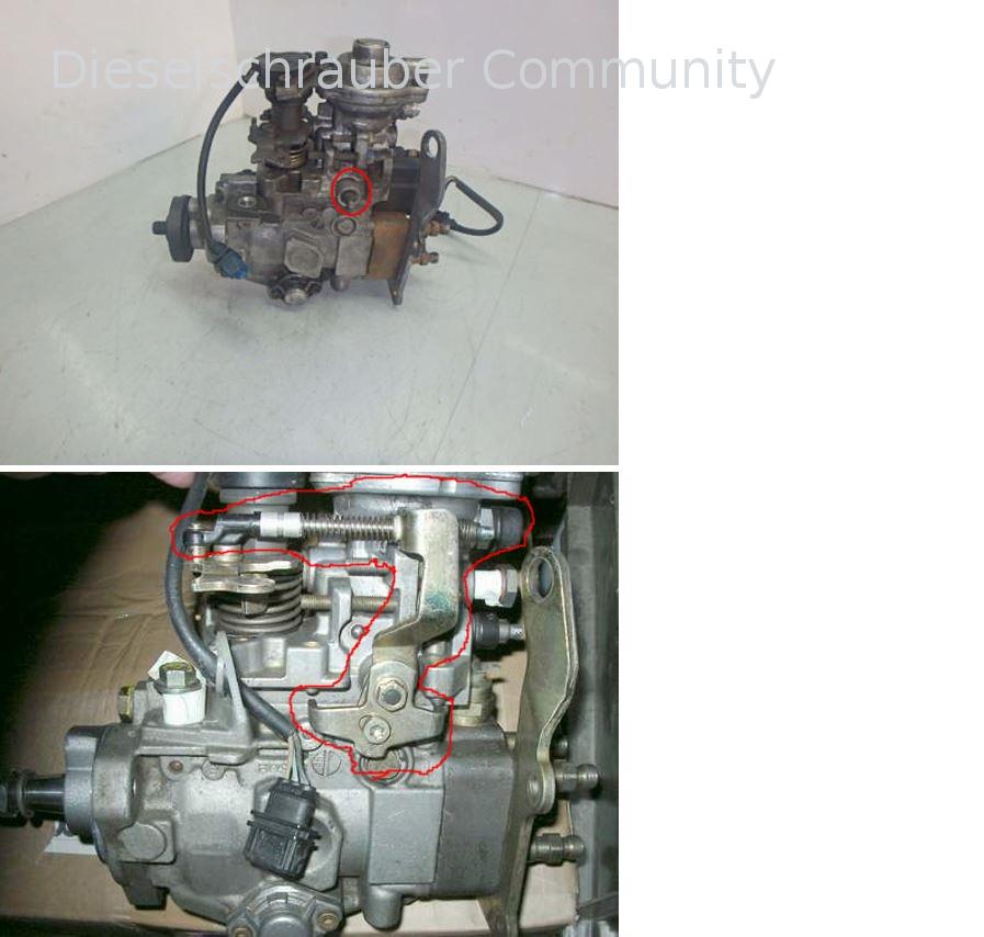

Hello everyone,
I'm currently building a mechanical TDI engine using an ALH motor from a Volkswagen Golf 4.
For this, I'm using an injection pump from a Land Rover Discovery 300TDI that I bought online.
Now I've noticed that the purchased fuel pump is missing an adjustment mechanism that should actually be there. It's located where the cold start accelerator usually sits on older VW pumps.
(Image: Top is my pump, bottom is a picture from the internet -> this is how it's supposed to look originally.)
In the case of the Land Rover pump, the mechanism is not operated by a separate cable, but is linked to the accelerator pedal.
Can someone tell me what this is for and whether I can live without it, similar to how some people live without a gallbladder (KSB)?
Thank you and best regards.

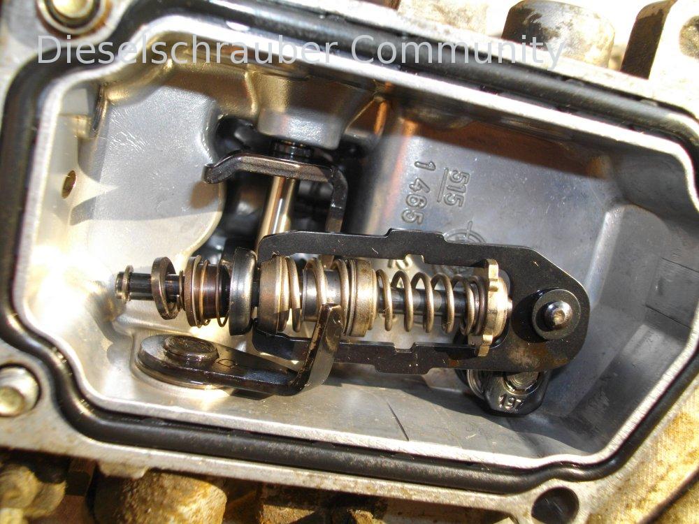

Okay, apparently nobody knows. Then it probably isn't important  .
I opened up the pump for a while.
The lever actuates a hook (located at the bottom of the image), which, as far as I can tell, limits the range of movement of the centrifugal governor.
Well. I hope this is only related to emissions or something like that. I'll try leaving it out for now.

Herbert Profi-Schrauber
Joined: 06/22/2005 Posts: 4639 Karma: +1353 / -0
11-12-2017, 22:07 Subject: VP37 Injector Pump: What is the function of this adjuster? |
Quote |
There are two types of VP37 units. In one, the pulley with its spline is mounted directly on the hub. In the other, the pulley is attached to a separate hub using three screws. With the latter type, after loosening the wheel, you can lose the hub assembly from the ESP shaft. The hub must remain securely in place.
Regarding your mechanical injection pump: isn't the shaft actuated from the right side (when viewed from the belt)? What part has been removed in the picture, which is unclear?
Sure, here's the translation:
"P.S.: If you look closely, the questioned adjuster has two close stops and should be operated via the throttle lever. It acts as a "counter-bearing" for the throttle mechanism inside the pump (?). "
Facial expressions are also present in AAZ (presumably referring to a specific context or group).
Translated on 10-08-2026, 4:22.

Hello everyone.
The lever at the top was introduced by the European standard.
It only releases the boost pressure enrichment (LDA) at the throttle valve lever when a certain driver demand (accelerator pedal position) is reached, in order to prevent black smoke at low speeds.
Avoid operating in the low-load range.
If you leave it open, nothing will happen. It should stay open, otherwise the whole thing will become sluggish if no "material" is released  .
Regarding the 1.9TD pump, while it might make the TDI run, the injection timing is completely unsuitable for a TDI engine. The combustion process (ignition timing, ignition speed, burning rate, and combustion temperatures of the injected diesel) differs significantly between engines with swirl chambers and direct injectors.
Therefore, it is...
- Increase the opening pressure of the nozzle holders.
- The impeller design in the TDI is completely different.
- The hydraulic valve timing adjuster is designed with a completely different adjustment curve.
Therefore, the fuel pump from a 2.5/3.0 TDI Land Rover, or those from the 2.5L Fiat Ducato or 2.5L Citroen Jumper, are much better suited for this conversion.
In addition, you also benefit from the larger pump piston  .
Regards, Mpire.
