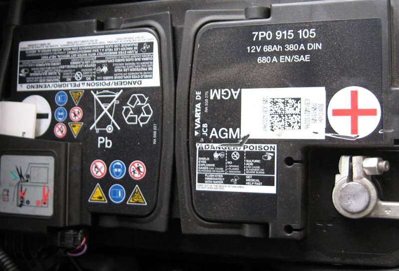

A comparison with the battery in the 8PA revealed that it is also an AGM type, but VCDS displays "wet cell battery." It was not possible to code it as an AGM battery, which suggests that the coding information may need to be adjusted.

Okay, I'm ready. Please provide the German text you want me to translate into English. Just paste it here, and I will give you the translation.
 AGM Batterie 68Ah im Audi A3 8PA

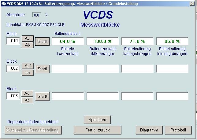

The A3 is still coded to use a wet battery and does not accept AGM batteries. icon_idea.gif
Charge-related aging: This is how much energy the battery can store.
Ageing related to performance: This is the maximum starting current that the battery can deliver.
 AGM Batterie in Audi A3 nach 80.000km.
 File size:  46.13 KB
 Viewed:  10811 times

How old is the battery you showed me?
Translated on 18-08-2026, 22:27.
Posts: 18113
Post29-05-2014, 11:44    Subject: AGM Battery Charging: How To & Tips Quote
brezelmann01 wrote:
How old is the battery that you showed me?
The battery is from the beginning of 2010, so it's a little over 4 years old.
