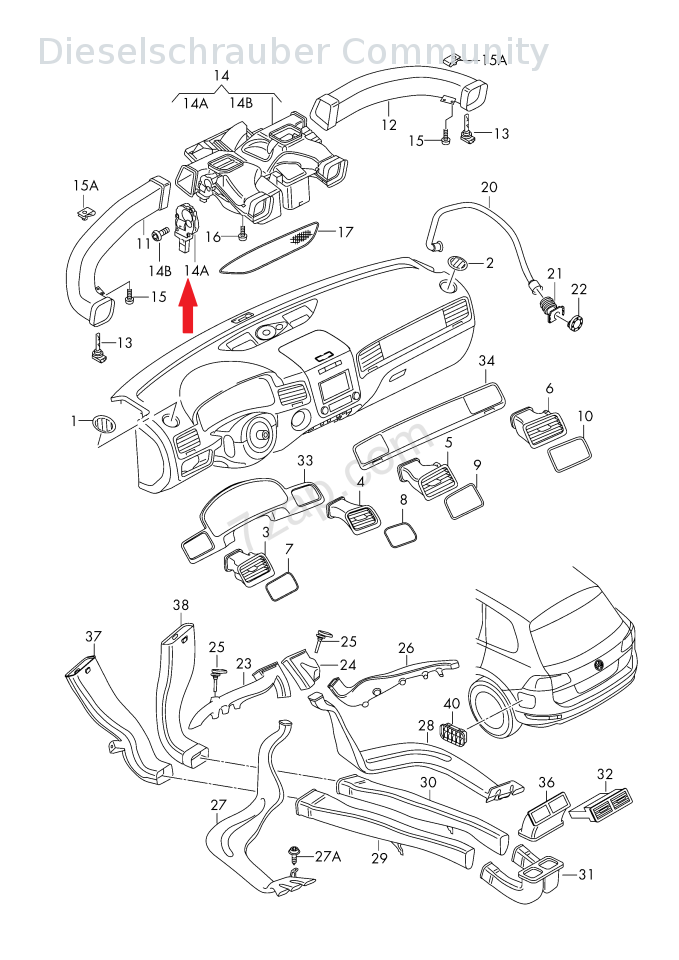

Currently, I'm experiencing the following problem with my Passat 3C 2.0 TDI (140 hp), manufactured in 2006, with a hatchback body style:
The VCDS software displays 3 errors related to the ventilation/climate/heating control motors: V158, V71, and V213. See the attached log file.
I'm actually only interested in the expansion of the V213 stepper motor.
It is located to the right of the speedometer and is responsible for controlling the ventilation flaps in the center. (See image: exploded view).
My question is whether I can access the V213 servo motor by removing the speedometer and the radio. This seems like the easiest way to me. Has anyone had experience with this? Or could someone perhaps offer some advice on how to remove the servo motor?

Unfortunately, I forgot to mention in my previous message that I'm hearing a mechanical "scraping" sound from the V213 area, occurring every 0.5 seconds. Also, no air is coming out of the air vents in the center console. When I clear the V213 error code, it immediately reappears.
The observation is that the motor is running, but the mechanism is not opening the valve for the air outlet. Therefore, I suspect that either the motor is faulty or there is a problem with the mechanism after the motor.
It would be interesting to know the exact type of the V213 servo motor beforehand, so I can install the new one directly.

Yes, it makes sense now not to buy the motors right away, but maybe there's just a lack of lubrication in the mechanism.
Unfortunately, my concern is that I may have to completely remove the entire control panel to access the V213 actuator.
Therefore, my initial question was whether simply replacing the speedometer and radio would be sufficient.
I'll probably just try it. If that doesn't work, then there's probably no way around buying the instruction manual https://www.originalanleitungen.de/vw-passat-b6-typ-3c-05-10-karosserie-montagearbeiten-innen for €34.90 and completely disassembling the entire control panel. Because that annoying noise, lasting only 0.5 seconds, becomes unbearable in the car over time.
"Nevertheless, thank you for the response. If anyone could contribute any further helpful answers, I would be very grateful."

Try accessing the motor from below. That's how I did it with my A4, model year 2005. I just had to remove the lower panel, and then I could reach the motor.
Andreas

Do you mean "below" when referring to the area from the driver's footwell?

William wrote: | | Do you mean "below" when viewed from the driver's footwell? |
Yes. Usually, there's a cover or compartment located under the steering wheel. If you've removed that, you'll probably already be able to see the engine.
Andreas
