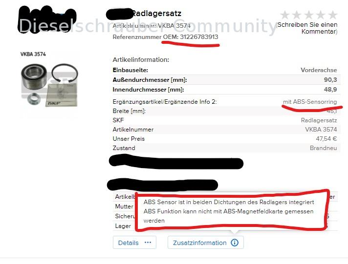

Hi there,
It's clear that you won't find anything, because the magnetic segments are integrated into the bearing shield of the wheel bearing.
It's been like that since the E39. You probably need to replace the wheel bearing.
"Stick with SKF or FAG; I've had signal problems with other brands after replacing the wheel bearings."
Part number: 31226783913
Applicable to the following vehicles:
BMW 3 Series Sedan (E90) (Production year 03.2005 - 10.2011, 163 - 306 hp, Gasoline, Diesel)
BMW 3 Series Coupe (E92) (manufactured from March 2006 to December 2013, 177 - 306 hp, gasoline/diesel).
BMW 3 Series Touring (E91) (manufactured from August 2005 to June 2012, 163 - 326 horsepower, gasoline, diesel).
BMW 5 Sedan (E60) (Production year 09/2004 - 03/2010, 197 - 272 HP, Gasoline, Diesel)
BMW 5 Series Touring (E61) (Production year 02.2005 - 12.2010, 197 - 272 HP, Gasoline, Diesel)
BMW X3 (E83) (manufactured from November 2003 to December 2011, 136 - 286 horsepower, gasoline, diesel).
BMW X5 (E53) (manufactured from May 2000 to December 2006, 184 - 360 horsepower, gasoline, diesel).
Regards,
Mpire

Post22-02-2019, 11:01    Subject: BMW E61 530xd, year 2006, ABS ring Quote
Here's how you can identify the wheel bearing for the front:
