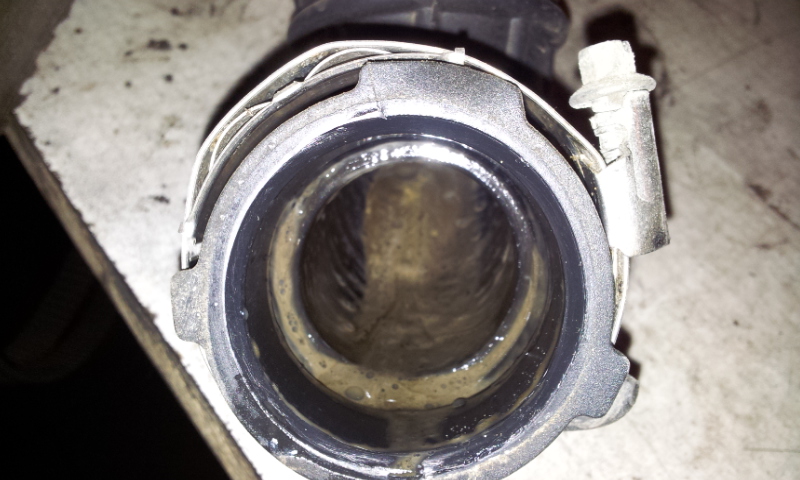

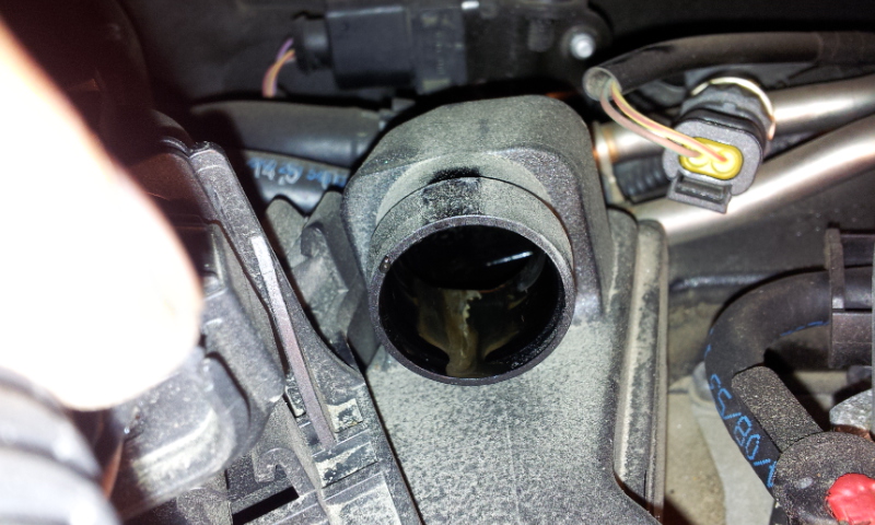

I wanted to continue working on the Audi A4 today. The outside temperature was around -7°C.
After driving for about 2 kilometers in the city, it started to smoke and smelled burnt.
I then rode the remaining 2 km home, and after parking and checking the engine oil, I put it in the garage. After that, it stopped smoking.

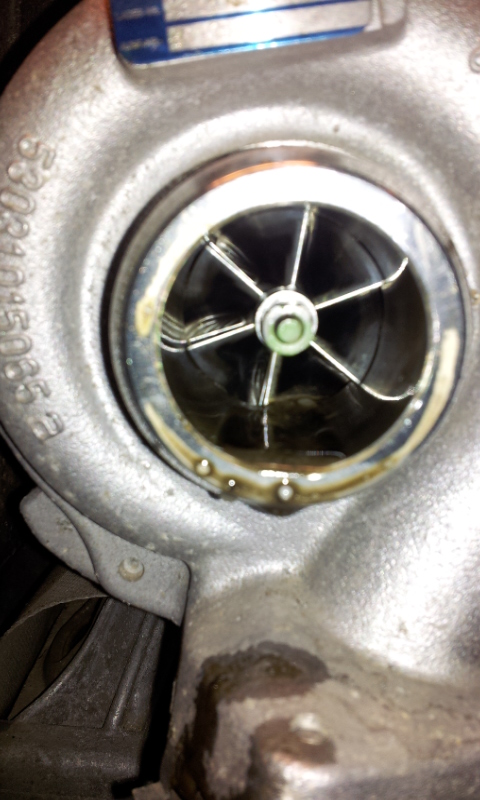

I initially thought it might be a faulty turbocharger, but the oil level was okay. However, there was an oily substance on the exhaust pipes, which wasn't black, but rather quite light in color.

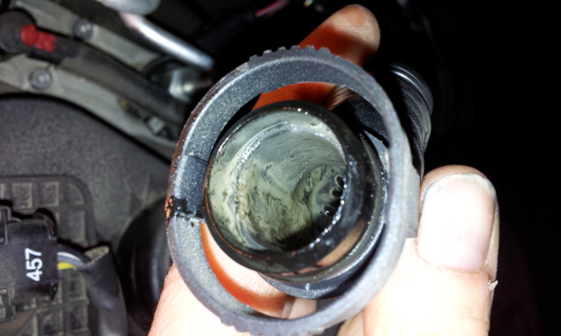

I then removed the breather hose and a mixture of water, oil, and sludge came out. The same was visible in the intake hose from the air filter to the turbo, starting at the opening of the breather hose. It was also present in the hose before the throttle body.
Is there also a problem with the vent freezing up on these engines?

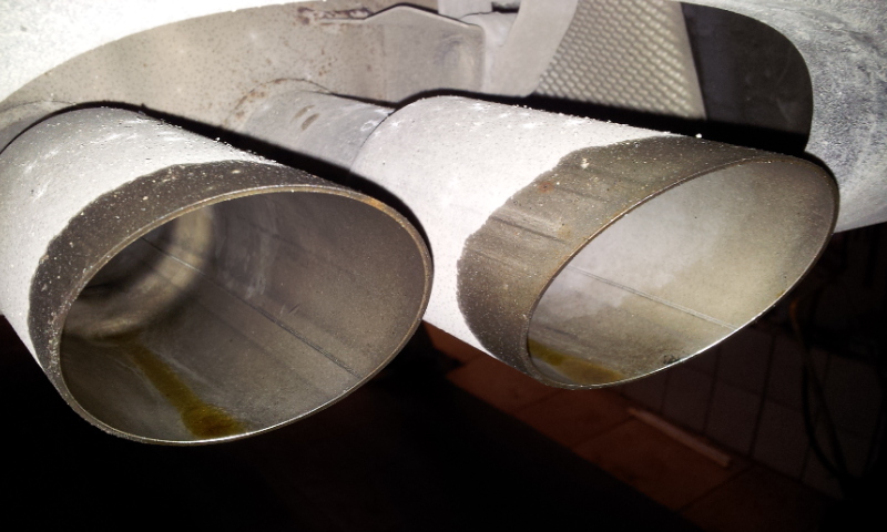

Where does the oily substance in the exhaust come from?
I must have been in the process of regenerating at the time I was smoking, as the mileage and the time since the last regeneration roughly coincided with when I was smoking.
The car is used almost exclusively for long distances (approximately 50 km twice a day), which is why I'm also surprised to see traces of oil/water in the ventilation hose.

Please check if you are losing any coolant and make sure the oil level is okay.
If the loader receives a sudden surge of liquid during operation, it can damage the compressor impeller.
The images suggest two possible causes based on my initial assessment.
- Primarily drives short distances; the car never warms up properly.
- something is broken.

If the engine had been running properly, the oil emulsion would not have been ejected from the exhaust but would have burned off. Please definitely check the condition of the fluids in the oil and water circuits. Both should only contain either oil or coolant, respectively. The information about the type of driving (e.g., short trips) and the general usage profile is also important.

Nowadays, the valve cover incorporates a complex system of labyrinths and flaps designed to separate oil from the air stream.
Possibly, they are frozen or broken, causing the MÖL to be ejected in large quantities.
For testing purposes, direct the venting to a separate container.
Better ideas?

dieselschrauber wrote: | Caution, please check if you are losing any coolant and that the oil level is okay.
Best regards, Rainer |
Fluids are okay, both oil and coolant.
I mentioned that the car is used for long-distance driving 98% of the time. That's 100 kilometers per day, five days a week (50 kilometers to work and another 50 kilometers back).
EDIT: UNTIL THIS DATE, I HAVE NOT OBSERVED ANY WATER CONSUMPTION, with the expansion tank between its minimum and maximum levels.

Quote: | | If it had regenerated, then the oil emulsion would not have been ejected from the exhaust but would have burned off. |
I think it's condensed oil vapor that was already in the exhaust before the regeneration process. The light color indicates an intact DPF  .
Quote: | Nowadays, a bunch of labyrinths and valves are built into the valve cover to handle oil separation.
As a test, direct the venting to a separate container. |
 . Regarding the engine ventilation system, including the valve cover, I would also start there.
The emulsion is naturally exacerbated by the extremely high humidity of recent weeks.

Yesterday, after driving twice for 50 km each time, the same thing happened again.
Okay, I've now directed the venting process into a plastic bottle and briefly short-circuited the EGR cooler hoses. The coolant level hasn't changed, but this is just for testing purposes.

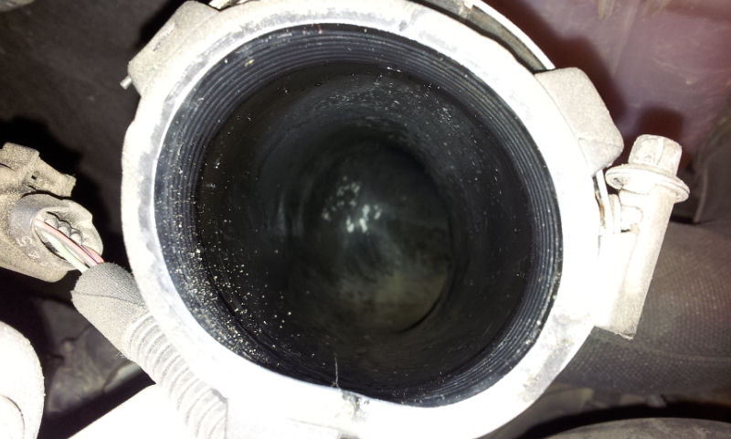

Also, also check the intake area and air filter to see if it's somehow sucking in stagnant water or water that has accumulated during rain. It's very strange for a vehicle designed for long distances.
