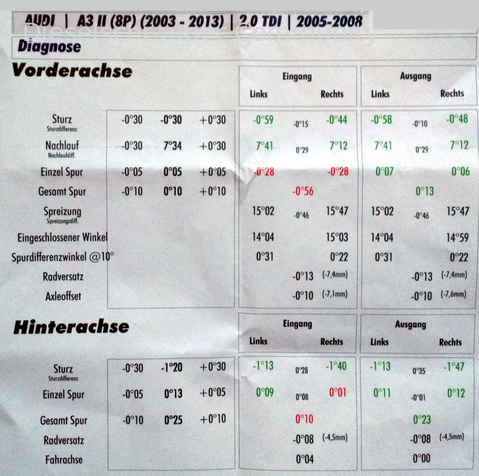

Post02-07-2020, 17:52    Subject: Front tires worn on the inside, Audi A3 Quote
Everything is back to normal. Attached are the target values for the alignment settings of an Audi A3 8P.
 Sollwerte für die Spureinstellung eines Audi A3 8P

Post02-07-2020, 19:16    Subject: Clear correction Quote
Clear correction. The sag values are still quite negative, especially in the front left. Is the rear axle also adjustable on this model?

Posts: 18064
Post02-07-2020, 20:28    Subject: Subject: Clear correction Quote
Hello Herbert,
Herbert wrote:
...Is the rear axle also adjustable on this model?
a hunch. icon_smile.gif However, everything is fine at the rear, which I define as meaning that nothing has ever been done to it, nothing has ever gone wrong with it, everything functions as it should, and the tires show normal wear.

Post03-07-2020, 11:34    Subject: Front tires worn on the inside, Audi A3 Quote
Hi.
Regarding the negative camber in the rear... unfortunately, I lack a sense of the scale at which certain things become noticeable.
Could it be that the negative camber (i.e., the wheel stands lower on the inside than on the outside, https://de.wikipedia.org/wiki/Radsturz) due to wear on the wheel bearing)? As I said, nothing has ever been done to the rear of the vehicle, not even any minor collisions or bumps.
I would definitely leave it like that because the tire wear is incredibly even, even on winding roads.
However, I would still like to know the cause of the difference compared to the target value. Or is this normal for a vehicle that's about 10 years old, because the wheel suspension has simply settled or shifted slightly?

Post07-07-2020, 21:03    Subject: Front tires worn on the inside, Audi A3 Quote
Hello Rainer,
Do these values also match the installed suspension? The A3 had three options, including the "Magnetic" suspension. These values correspond to the "Dynamic" suspension, which is standard on the "Attraction" trim level. The Ambition already had the sports suspension.
LG

Post08-07-2020, 19:25    Subject: Front tires worn on the inside, Audi A3 Quote
Yes, absolutely.
Unless you have actively opted out.
Take a look at the PR codes.
Attraction: Standard suspension = Sport suspension = UA0/UA4
Ambition: Sport suspension = UA1/UA5/UA9/UA6
