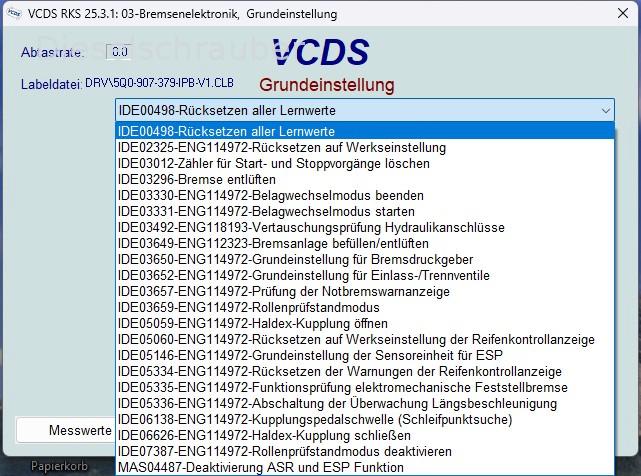

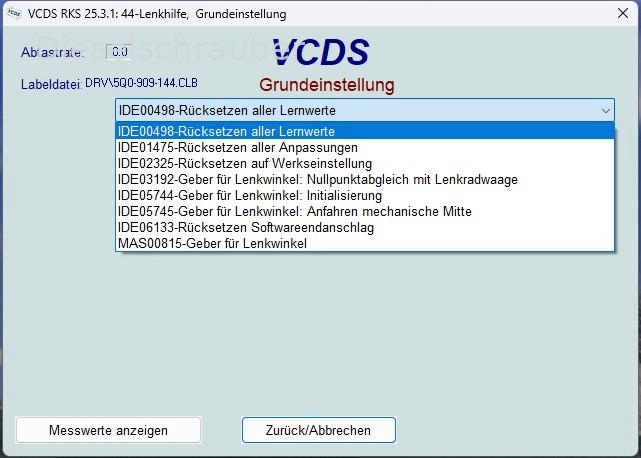

Due to my own mistake, I have damaged the basic values in the braking system of my 2014 Audi S3 Sportback (8V). I was able to calibrate the long and short-axis accelerometers, and now I only have 3 errors in the memory:
Code: |
Address 03: Brake Electronics (J104) Label file: DRV\5Q0-907-379-IPB-V1.clb
Part Number SW: 5Q0 907 379 AA HW: 5Q0 907 379 G
Component: ESC H31 0457
Revision: 00000000 Serial Number: 62753000000094
Encoding: 32F16BA254282A6F037D070941C8694CD62A54C0E08296F7024150788508
Operating Number: WSC 06314 790 00021
ASAM Dataset: EV_Brake1UDSContiMK100IPB 033001
ROD: EV_Brake1UDSContiMK100IPB_033_VW48.rod
VCID: 7BA2F705136645D20A9-802E
3 error codes found:
0295 - Steering Angle Sensor
B1168 54 [10001001] - No default setting
Warning light ON - confirmed - checked since last discharge
Environmental Conditions:
Error Priority: 2
Frequency of Errors: 1
Lost Count: 137
Date: 2025.06.06
Time: 18:38:22
8342 - Button for Tire Pressure Monitoring Display
C10C6 29 [10001001] - impossible signal
Error Priority: 6
Lost Count: 137
Kilometerstand: 210460 km
Date: 2025.06.06
Time: 18:40:11
16390 - Tire Pressure Monitoring System (TPMS) Indicator
C1146 02 [10001001] - Signal Error
Error Priority: 6
Lost Count: 137
Date: 2025.06.06
Time: 18:38:31
The default setting for the steering angle, according to my observations, can only be done through the steering assist control unit. Unfortunately, the login code that VCDS suggests does not work for this purpose. Can anyone help me with that?
I hope that the problems with the tire pressure monitoring system will also be resolved at the same time. Otherwise, I'll have to go back and do it again.
Best regards,
Markus

hilfreich wären
- ein Autoscan;
- ein klarer Bericht, wie, womit, wobei, und in welcher Reihenfolge zerschossen wurde. Dann versteht man vielleicht das Zustandekommen des Fehlerzustands.

Hier der Screendump von der Bremselektronik:
Die Grundeinstellung für den Lenkwinkelsensor kann nicht in der Bremselektronik gemacht werden. Das muss scheinbar in der Lenkhilfe gemacht werden und da habe ich den vorgeschlagenden Logincode verwendet:
Die Fehlermeldung beim Geber für Lenkwinkel initialisieren:

[Translating...] Welche Möglichkeiten hast Du im ABS/ESP?

[Translating...] Optionen
Viele Grüsse
Markus

[Translating...] Das Problem konnte ich gerstern abend mit der VCDS-Anleitung zur Grundeinstellung Geber für Lenkwinkel beheben.
Viele Grüsse

Since the S3 8V belongs to the MQB model family, the basic setting for the steering angle sensor in the 44-steering assistance control unit must be made. The instructions for this can be found here. What the manual doesn't state is that a further test drive of a few hundred meters is also necessary so that the system can recalibrate itself.
Best regards,

da sind mehrere Anleitungen. Ich frage für die Community. Meinst Du Du die: UDS Fahrzeuge (MQB) oder die " UDS Fahrzeuge - Version 1" oder die " UDS Fahrzeuge - Version 2" ?

Since the vehicle I was having the problem with was an Audi S3 8V, which belongs to the MQB family, I naturally used the UDS manual for MQB vehicles .
Best regards,

[Translating...] Danke für die Rückmeldung!
Also für dieses Fahrzeug ist nur
Quote: | | UDS Fahrzeuge (MQB) |
relevant, korrekt?
Habe gestern noch bei Ross-Tech angefragt, mal sehen was die schreiben.

At least, this guide, combined with the subsequent test drive, led to success.
