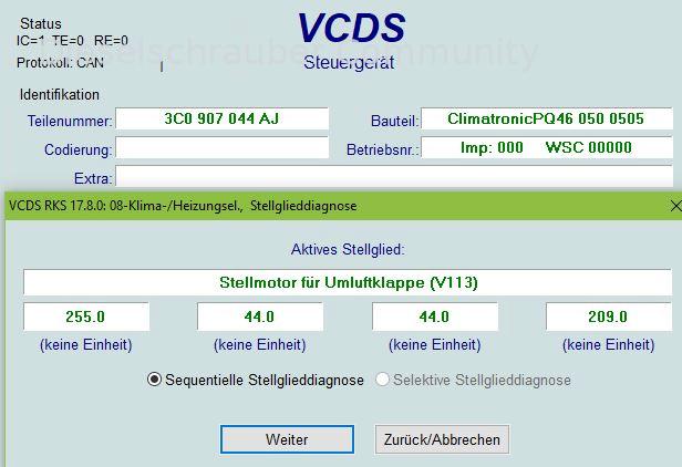

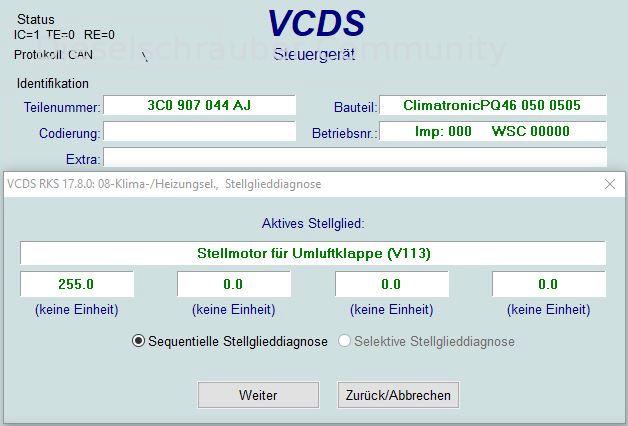

The image above (in my original question) shows the missing target value for the temperature control flap servo motor on the right side, V159.
Here's a comparison image of the actuator diagnosis for the throttle motor of the secondary air control valve V113 (with the connector cable disconnected). This actuator is relatively easy to access, as it is located directly behind the glove compartment.
When the connection cable is disconnected, the setpoint value - shown in the second position - changes as expected between the end values (which are also displayed to the right).
Only the actual value on the far left (in image 255) remains static (since the servo motor is not connected and the potentiometer is not being moved).
This is a completely different behavior compared to the problem I'm having with the temperature flap control motor on the right side (V159): Therefore, a cable issue, as initially suspected, does not seem to be the cause of the problem.
Perhaps the engine control unit has actually "disabled" the position sensor V159 (and is no longer communicating with it) because the engine is faulty or the final values could not be determined - for example, due to a problem with the potentiometer.
This is just a preliminary update - more to come soon.

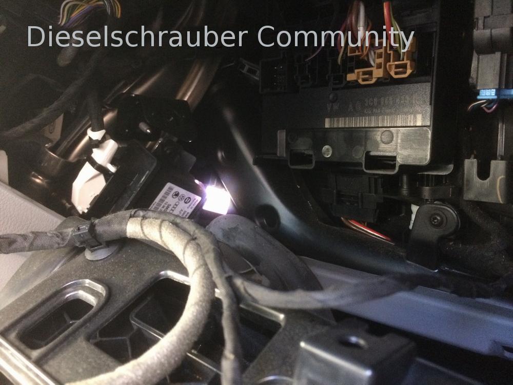

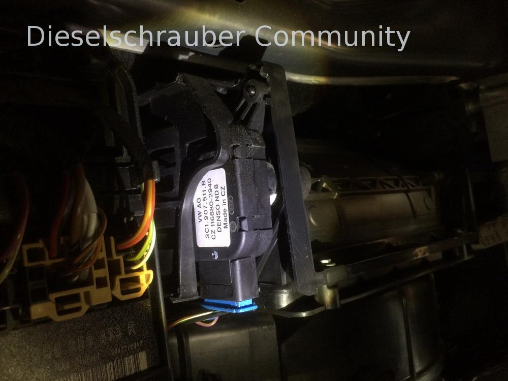

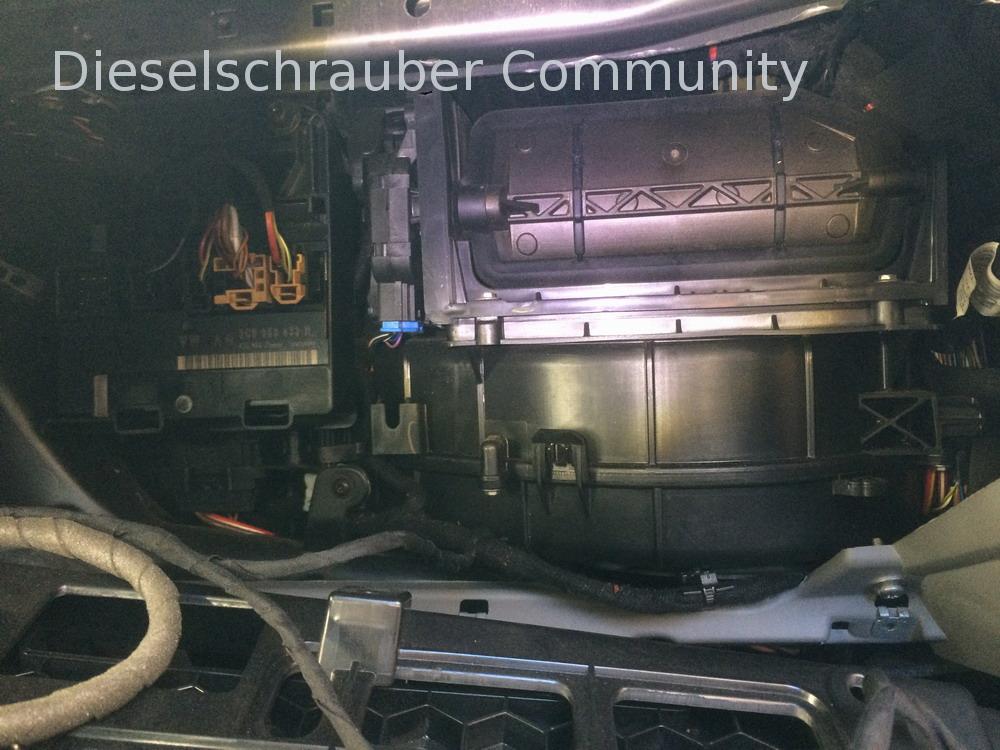

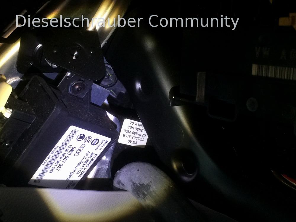

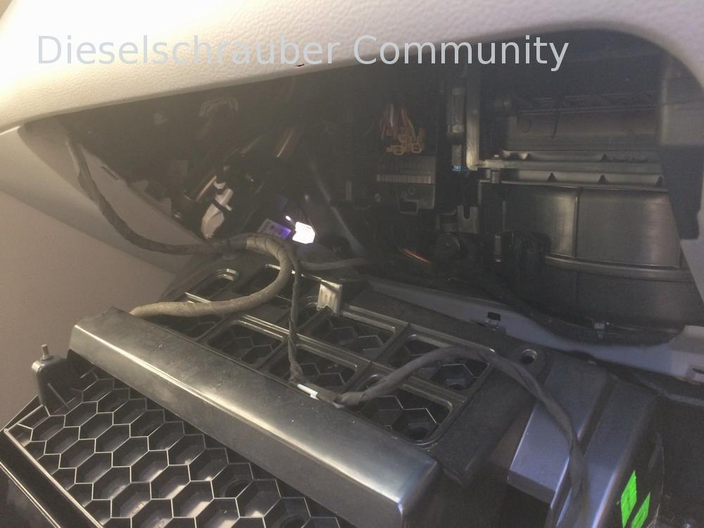

Here are a few more photos:
Image 1: View of the expanded glove compartment: On the left in the background (with a highly reflective label) is the temperature control flap actuator on the right (V159). To the right, above the blower fan housing, the (closed) recirculation flap is visible. Directly to the left and vertically adjacent is the actuator motor for the air control flap (V113) with a dark blue connector.
To remove the glove compartment for expansion, only 3 screws at the bottom and 4 screws at the top were loosened. It was then simply placed in the passenger footwell (with the connectors still attached). When disassembling, be sure to use a small screwdriver to release the locking mechanism at the bottom (near the air vent) as the final step.
Image 2: Overall view of the temperature control flap servo motor on the right side, V159 (which can be recognized by the highly reflective label in the background). It is obscured by a metal bracket and a control unit located in front of it. In the upper right corner of the image, you can see the blue connector of the secondary air flap control motor (V113).
Image 3: A closer view of the temperature flap control motor (V159) located in the background on the right side, and the control unit for cornering light and headlight range adjustment (5M0 907 357) located in front of it.
Image 4: Detail view of the servo motor for the right temperature flap (V159): 3C0.907.511.B
Figure 5: Larger view of the recirculation flap and the attached actuator for the recirculation flap (V113) with the blue connector.
Figure 6: Detail view of the recirculation flap servo motor (V113): 3C1.907.511.B
My plan is to first remove the functional recirculation flap actuator (V113), examine it, and take measurements. Then, I will remove the (problematic) V159 actuator for the right-hand temperature flap.
If I'm interpreting this correctly, both units are identical in terms of their motor and housing. The V113 connects directly to the axis of the recirculation flap, while the V159 has an additional lever attached. However, I believe the differences in the prefix ("3C1" versus "3C0") are probably not really significant, as those usually contain the supplier code or revision information.
I would then test the stepper motor (V113) for the recirculation flap (V113) on the right-hand temperature control flap to get closer to the source of the problem (before buying anything), especially since the V113 is very easy to remove as it is simply clipped in place.

I myself had also devised a test to examine the theory that "the failure to reach the target value is due to the inability to learn the final values."
And specifically like this:
    - Removed the cables from the actuator motor of the air flap V113. (I had already removed this for the planned comparison, so this was already done.)
    - Initial setup performed using a diagnostic device.
    - Idea: End positions cannot then be learned successfully, because there is no feedback from the positioning motor unit (since it is not connected).
    - Expectation: If the theory mentioned above is correct, then there should be neither end values nor a target value for the V113 recirculation flap.
Result: see image.
It now looks exactly like the problematic servo motor for the temperature flap on the right side (V159). See the Screenshot in the image at the very top of the original question.
Conclusion: If no end values can be determined for a servo motor during the initial setup ("basic setting" or via the control panel), it will no longer be activated (no "target value") as a result.
Therefore, there is a lot of evidence to support our theory (and that, for example, the motor itself or the potentiometer in the control unit V159 is defective).
However, I have to retract my previous statement that it couldn't be the cable (because, theoretically, it still could be, even though I consider it very unlikely).
I will report on the further progress later. In the meantime, best regards.

I already tested the replacement stepper motor for the right-hand temperature flap (V159) by connecting it (which required quite a bit of disassembly) and calibrated the end positions.
    Image 1: Now, there is also a target value present, which is 28 (in the second position, to the right of which are the final values), and the motor is in the final position of 28 (the actual value is shown on the far left of the image).
    Image 2: Here is the actuator motor during the actuator diagnosis, at the other extreme position (the actual value on the far left is 219).
    Figure 3: During the actuator diagnosis, the control arm (see also Figure 5) moves back and forth between its endpoints until the next diagnostic point is called up. Here, in a central position (current value 128)).
    Image 4: Photo of the connected (but not yet installed) temperature control valve actuator on the right side (V159) in the lower end position (at value 2icon_cool.gif.
    Figure 5: Motor V159 in the middle position (which corresponds to approximately the value shown in Figure 3).
    Figure 6: Motor for the temperature flap on the passenger side is now set to the other, upper end value (actual value 219).
The old motor, which has not yet been removed, can be seen in the background.

First, the good news: Replacing the V159 stepper motor for the temperature flap on the passenger side is actually possible icon_smile.gif - and it has been successfully completed: warm air is now flowing from the vents again (which is important given the current temperatures of up to -5 degrees), and the error messages have disappeared - as has the noise like squirrels in the dashboard...
See the video "Programming the V159 stepper motor for the temperature flap on the passenger side" below for a look at the adjustment function. (By the way: right is the 'high' position, left is the 'low' position).
Incidentally, the (black) arm of the actuator is very easily attached to the (white) arm of the valve actuator: before installation, slightly rotate the actuator unit so that the actuator arm of the motor and the arm of the valve actuator (shown in black and white in the image) align with the recesses. (Once installed, they cannot "disengage" because the openings will no longer be in a position where they can be separated.)
It is, incidentally, irrelevant in which position the (black) actuator arm of the actuator unit is located before installation: simply move the (white) arm of the valve actuator to the appropriate position. (Again: the entire actuator housing - not the arm! - must first be rotated during installation in order to be able to attach the actuator arm to the valve actuator.)
The unfavorable news (to put it very mildly) for all those who are reading this because they still have it ahead of them: very unpleasant work...
I probably could do it much faster the second time, but even then: it would involve significant contortions due to very difficult-to-reach screws.
Furthermore, all the videos I've seen on internet platforms get it wrong (more on that below), because it actually works exactly as described in the VW repair manual:
Unscrew the upper and lower screws of the support... Turn the support to the left until the mounting screws and the temperature flap V159 servo motor are accessible.
That sounds too simple to be true - and of course, it isn't: more on that shortly. Here are the images:
    Image 1: Replacement of the temperature control valve actuator on the right side (visible on the right in the background, with the white "1" upside down below it).
    Image 2: To access the V159 motor, the metal support visible in the background must be unscrewed at the top and bottom and shifted to the left.
    Image 3: Close-up view of the metal support
that needs to be unscrewed (from the top and bottom). The problem with the metal support is:
    - One of the two mounting screws at the top is partially obscured by a support plate (which is not mentioned in the repair manual) and is therefore extremely difficult to unscrew.
    - The support itself is screwed in at a third location, which the repair manual does not mention, namely to the cover, which is located, in essence, in the lower left corner of the recess for the glove compartment.
    - The cable harnesses attached to the support further restrict the support's mobility.
    - Even after removing the three points mentioned above (and the two screws at the bottom of the bracket), the bracket can only be moved with extreme difficulty (and very little).
The control unit for the lights (in image 1 on the left) is located on a cover plate, which - as visible in the video and in image 1 between the control unit and the actuator motor - covers the two left screws of the actuator motor assembly.
This cover plate does not need to be removed (all the videos I've seen make this mistake) - by the way, neither does the control unit for the lights, but the cover plate is attached to the bracket and needs to be moved to the left - with some effort...! - so far to the left that the two left screws of the actuator unit V159 are accessible (more or less, with maximum contortions).
Why am I writing this in such detail? To spare at least parts of my ordeal to someone who is about to experience something similar... icon_smile.gif

    Image 2, label peeled off: The part number 3C0 907 511 B (or at least its base) is manufactured by BOSCH as 0 132 801 363. (Interesting detail on the side: A DENSO product number CZ 116880-2872 is also printed on the label.)
    Image 3: When they are DENSO, the Stellarme (here, the temperature control valve V159 3C0 907 511 B) is always white, while when they are VALEO, they are black.
The motor (which, incidentally, is only clipped in, with no screws or solder joints) spins freely - when removed and connected to a 9V battery - and seems to be quite powerful.
Reconnected: The control lever (back to 9V) works perfectly and powerfully, and also returns to its original position when reversed. (Next, the potentiometer should be tested.)
Connect to pins 5+6. Pin 4 is not connected, and pins 1, 2, and 3 are for the potentiometer. The numbering is embossed inside the connector housing.

Post20-02-2018, 13:14    Subject: Temperature flap servo motor - no target value? (V159, right side) Quote
Phaidros wrote:
The engine (...) is, incidentally (...), running strongly.
(...) Next, the potentiometer should be tested.
Yep, that aligns with the typical error pattern.
1) You can clearly hear the valves clicking, which indicates a functioning engine.
2) In VCDS, one can observe that the position values change abruptly and to varying degrees.
Both indicate a functioning engine but a faulty potentiometer.
Is the potentiometer actually hermetically sealed, or can dust simply accumulate on the sliding contact?
As far as I understand, potentiometers often have a small "blind spot" (for example, due to a speck of dust). Consequently, the desired value is not reached, but rather the system is constantly regulated around that value. This, in turn, causes the abrasive belt to gradually grind its way through the material next to the dust particle...
I would be interested to see some detailed photos of the potentiometer and a measurement you've taken, if you're willing to do that.
Greetings.
Guste.
