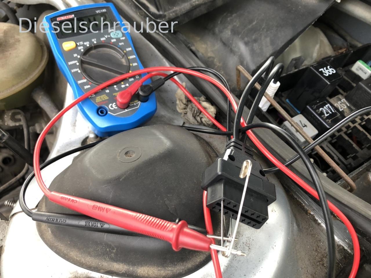

12V is present. The ground connection within the connector (pins 4 and 5) is established.
I've temporarily added something for testing purposes.
- The starter battery was disconnected for more than 10 seconds.
- used a different USB port.
- Used a different USB cable.
(The last two points are just out of desperation; the interface works perfectly with this notebook in my Golf.)

Please take a voltage measurement with a load connected (using a test lamp).
You can also try taking the measurement with the interface connected and measuring the voltage at the 2x2 connector on the back.
The measuring device shows approximately 12V whether the test lamp is connected or the diagnostic connector is plugged in.

The K-Line also provides 12V when the system is in standby mode. Please do not confuse the two connectors and under no circumstances connect them with reversed polarity!
Plug in your OBD2 adapter and take measurements at the OBD2 connector.

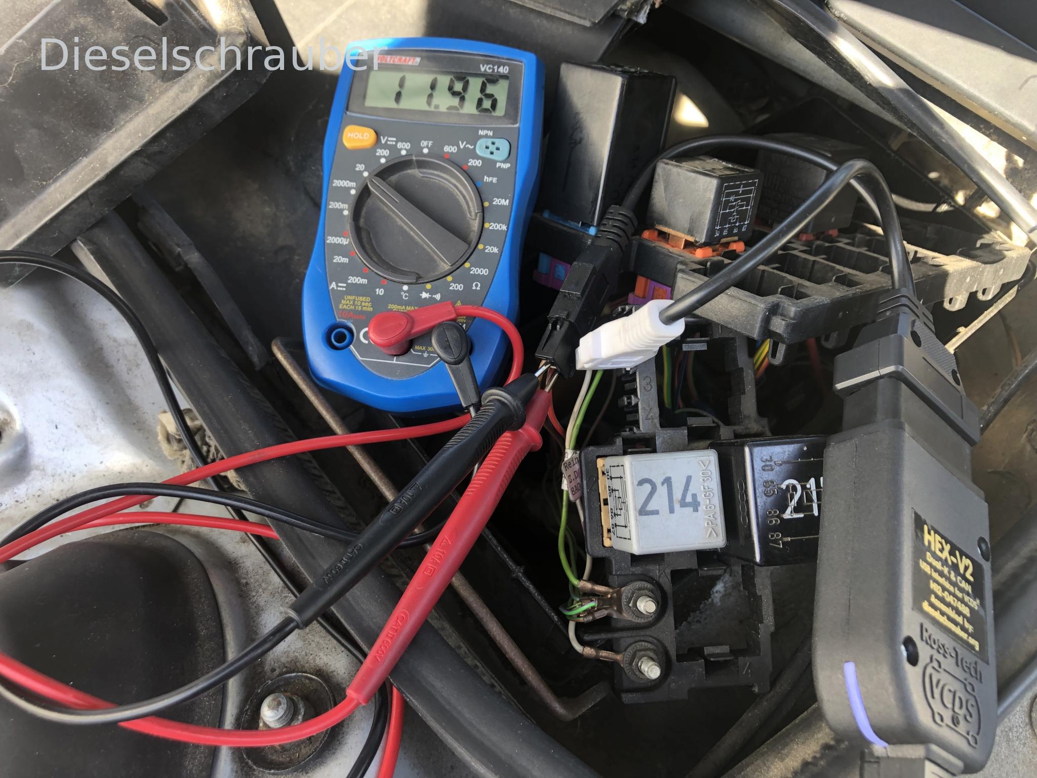

Wichtig wäre, ob am OBD2 Stecker vom Adapter die +12V Betriebsspannung ankommen und auch die Masse Kontakt hat.
With the adapter connected, there is a ground connection on both pins, as well as 12V on the positive terminal and 10V on the K-line. (Are the 10V correct, or should it be 12V?)

What is definitely not okay is the lack of a 12V power supply for the diagnostic cable. Hopefully, the ignition is always on when using it?

What is definitely not okay is the missing 12V operating voltage for the diagnostic cable. Hopefully, the ignition is always on in this case?
Something's gone wrong.
The diagnostic cable is receiving 12V (as shown in the Screenshot above), and the ignition was also turned on in each case.
